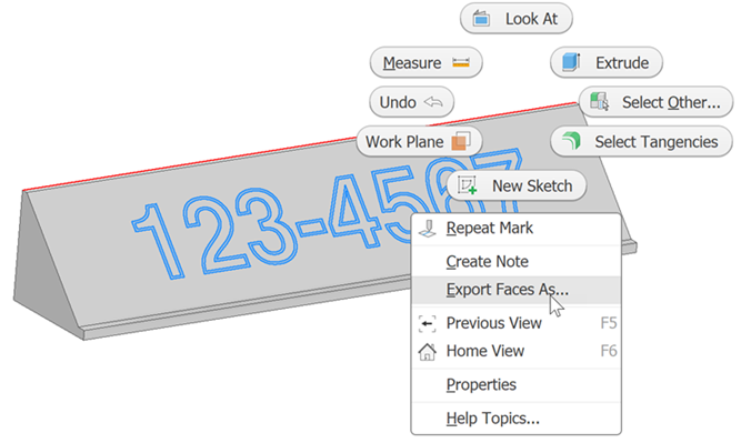

Exporting Planar Faces
The Export Face As command now supports exporting either individual or multiple faces at one time. When you have multiple coplanar faces selected, the export option displays in the selection context menu.

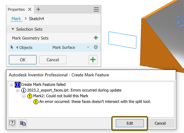

Mark Feature
Some conditions can result in an error message, for example, when an edit causes sketch geometry to no longer lie over model geometry. When that occurs, you can edit the sketch from the error dialog and quickly resolve the issue.

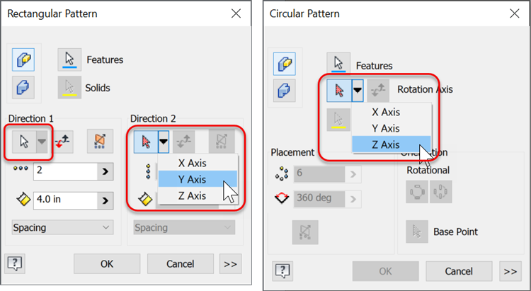

Feature Patterns
The feature pattern commands, Rectangular and Circular, now have a selector flyout that gives access to the Origin axes.

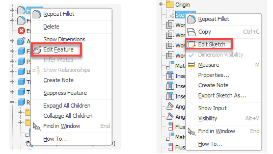

Shortcut Keys in the Context Menu
It is now possible to use the shortcut keys in the context menu to edit sketches or features directly. Select a feature or sketch, right-click and use the shortcut key. The following shortcut keys are available:
- K Edit Sketch
- F Edit Feature
