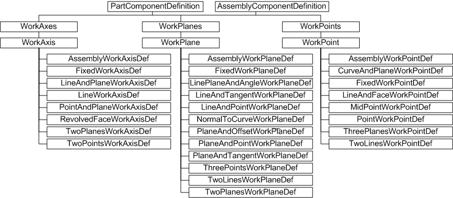

Use work features to construct abstract geometry, avoiding the need for complex calculations to determine feature location. The three types of work features are reflected in the API with the WorkPoint, WorkAxis, and WorkPlane objects, and their corresponding collection objects.
When working with work features through the user interface, all the information needed to place the work feature is inferred from the objects selected, where they were selected, and the order in which they were selected. This isn't feasible through the API, therefore there are a number of work feature subtypes derived from the three base types. For example, to create a WorkPoint at the intersection of three planes, use the ThreePlanesWorkPointDef object. Create this type of WorkPoint object by calling the AddByThreePlanes method of the WorkPoints collection. This takes three planar objects as arguments. Note that typically such arguments are quite flexible. In this example, the planar objects can be sketches, faces, or WorkPlane objects, or any combination of these. In this manner it is possible to build complex construction geometry.

Work Features Object Model Diagram

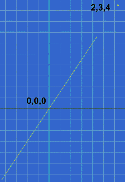

The following code creates a WorkAxis and adds it to the WorkAxes collection. The AddByTwoPoints method is used, so another WorkPoint is defined with X Y Z values of 0, 0, 0. So the WorkAxis will be defined by two points; the previously created WorkPoint at 2, 3, 4, and a new one at 0, 0, 0.
Dim oWorkPoint2 As WorkPoint
Set oPnt = oTrans.CreatePoint(0, 0, 0)
Set oWorkPoint2 = oPartCompDef.WorkPoints.AddFixed(oPnt, False)
Dim oWorkAxis As WorkAxis
Set oWorkAxis = oPartCompDef.WorkAxes.AddByTwoPoints(oWorkPoint1, oWorkPoint2, False)
The AddByTwoPoints method creates the WorkAxis and adds it to the WorkAxes collection. Note the third argument again indicates that the newly created work feature should not be considered application-specific construction geometry. It is displayed on screen, appearing something like this:

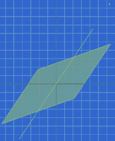

Dim oWorkPlane As WorkPlane
Set oWorkPlane = oPartCompDef.WorkPlanes.AddByLinePlaneAndAngle _
   (oWorkAxis, oPartCompDef.WorkPlanes.Item("YZ Plane"), 45, False)
oWorkPlane.Name = "MyFirstWorkPlane"
The last line of code names the newly created WorkPlane object MyFirstWorkPlane. Other code can use this name to reference this work feature. The new name is also displayed in the Autodesk Inventor browser, provided the work feature is not application-specific construction geometry. It is displayed as follows:
