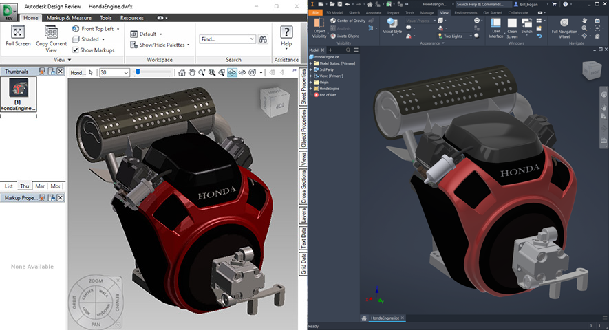

DWFX Export
Inventor DWFX export has improved mesh display when opened in Design Review.
