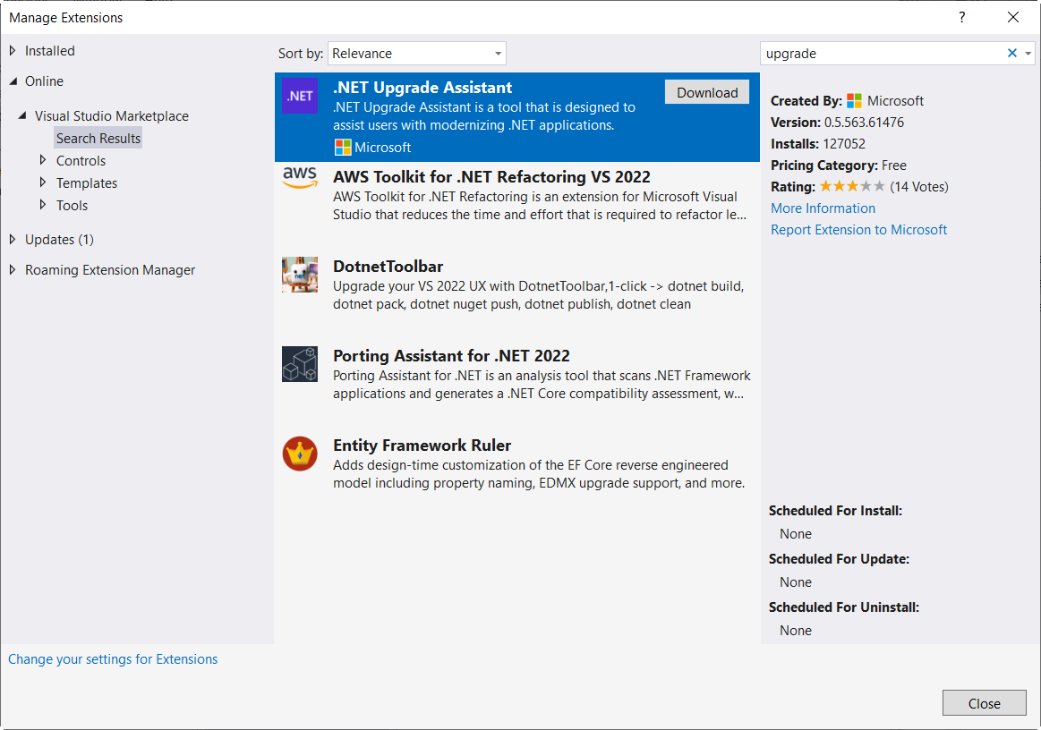

Upgrade Assistant:
Install the Visual Studio extension “.NET Upgrade Assistant”, refer to Install the .NET Upgrade Assistant:

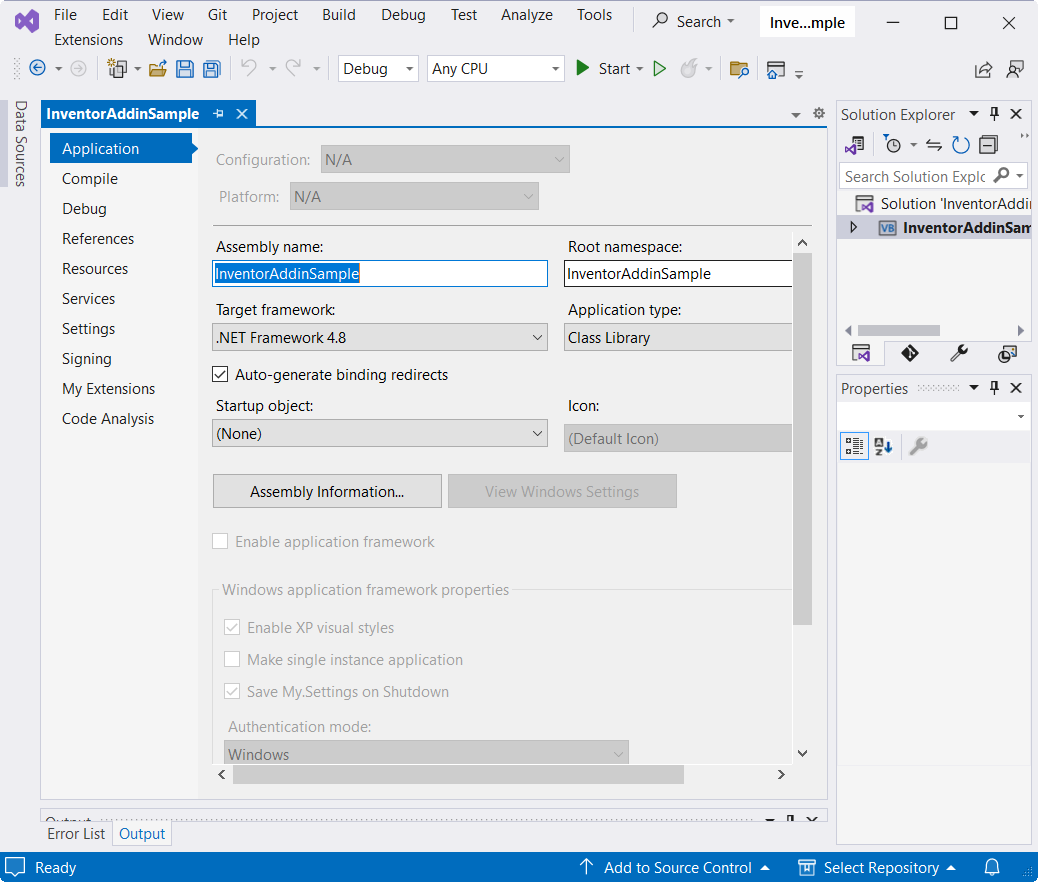

Open an Inventor project (below is based on a simple VB.net Inventor addin as
example, which is targeted to .Net Framework 4.8).

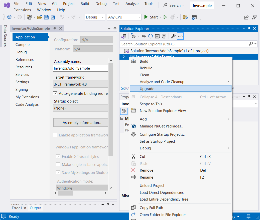

Right click the project, and choose Upgrade command:

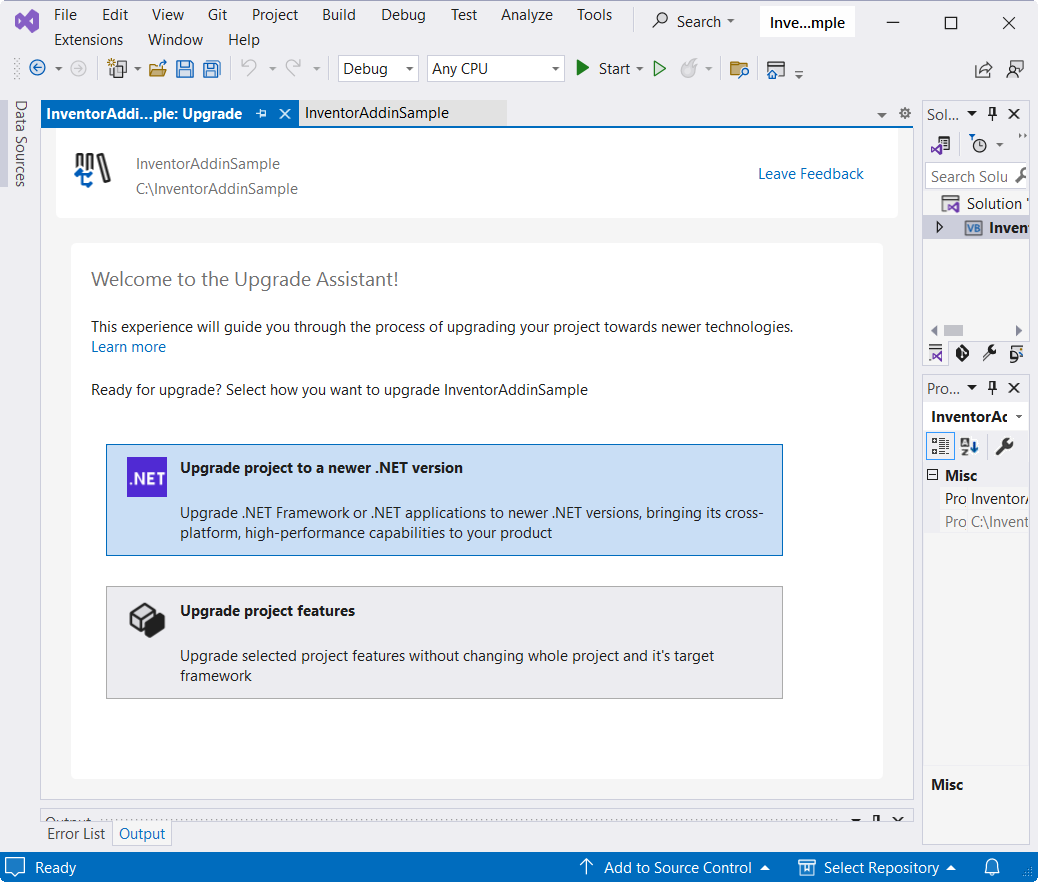

Choose “Upgrade project to a newer .NET version”:

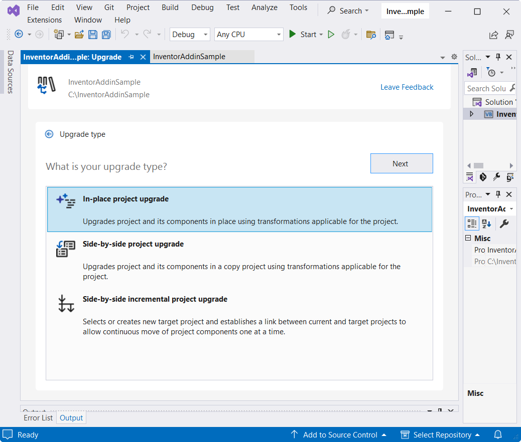

“In-place project upgrade”, and click Next:

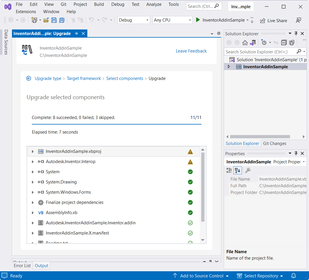

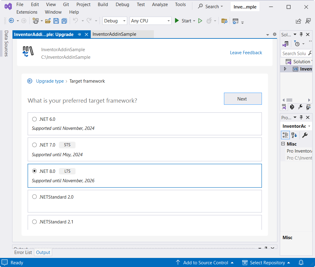

Choose “.NET 8.0” and click Next:

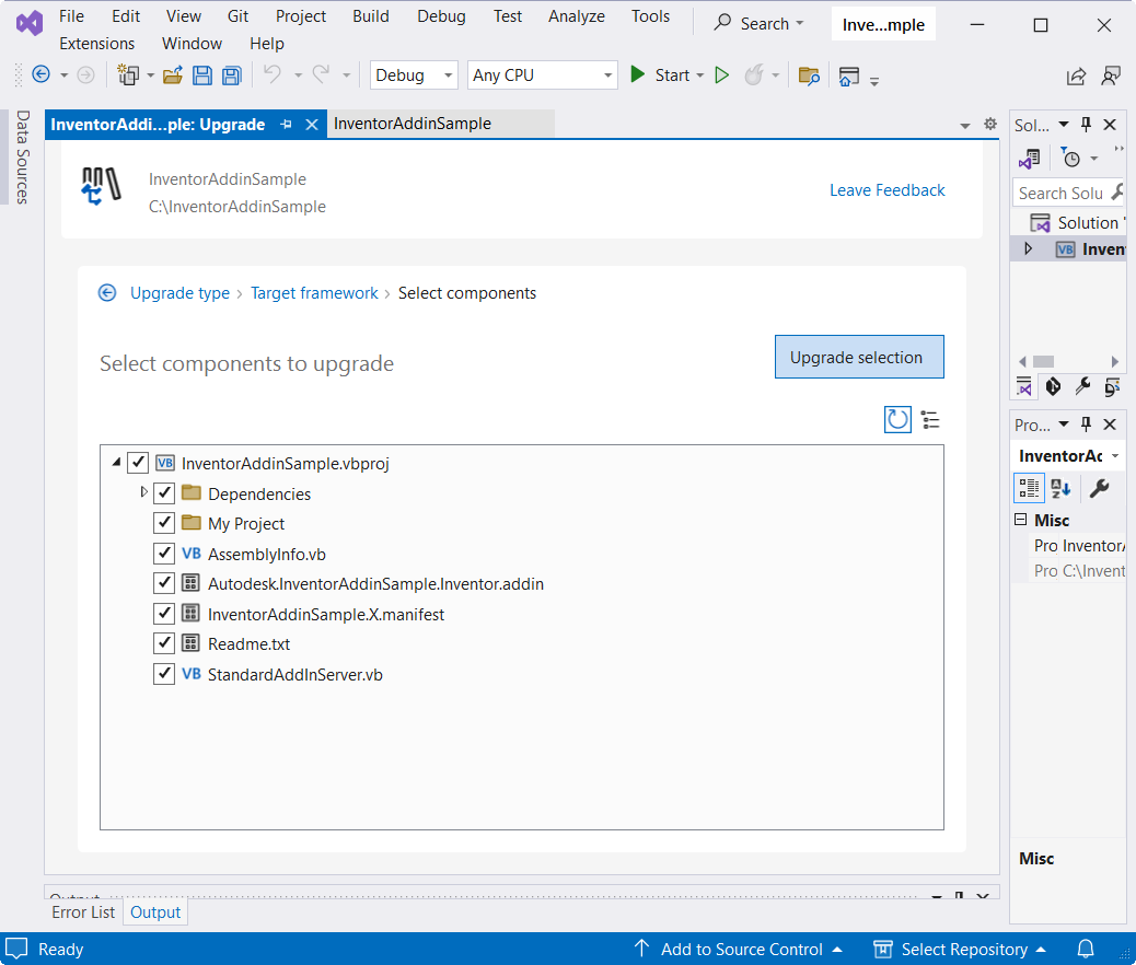

Select all if you are not sure which ones need to migrate and click Upgrade selection:
Now the migration result is as below:

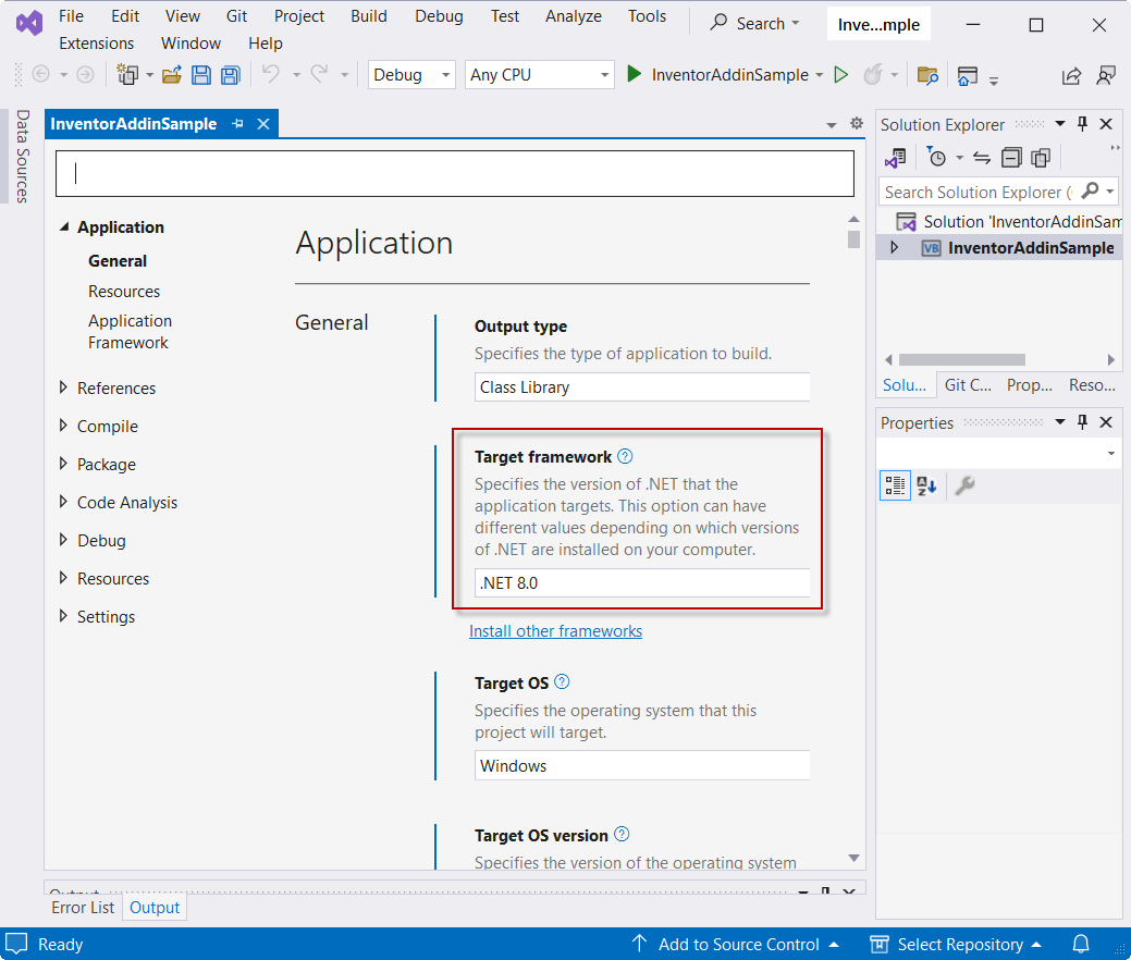

Check the Project Properties the Target framework is .NET 8.0 now:

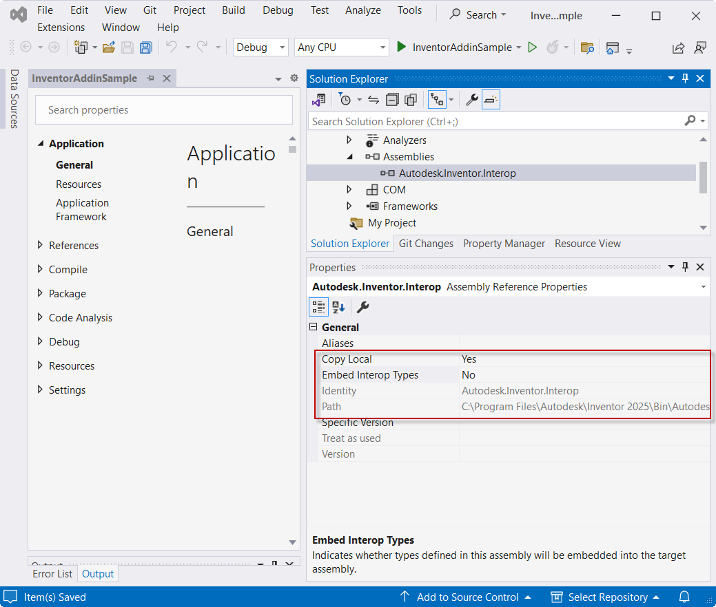

Re-reference Autodesk.Inventor.interop.dll from C:\Program Files\Autodesk\Inventor 2025\Bin\ folder, and set the “Embed Interop Types” to False, “Copy Local” to True:

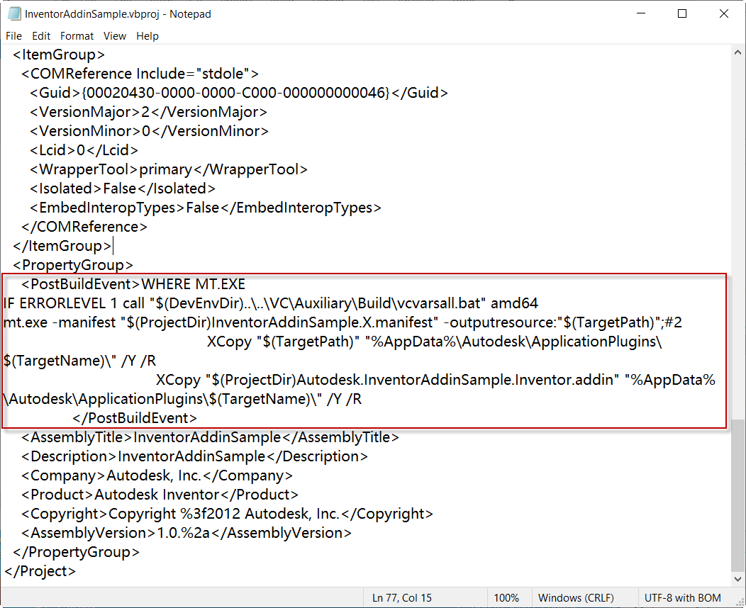

Edit the InventorAddinSample.vbproj using a text editor, and delete the below <PostBuildEvent> tag for Post Build Event:

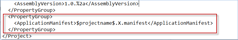

Add below <PropertyGroup> tag to <Project> for embedding manifest file to the result binary:
<PropertyGroup> <ApplicationManifest>$projectname$.X.manifest</ApplicationManifest> </PropertyGroup>

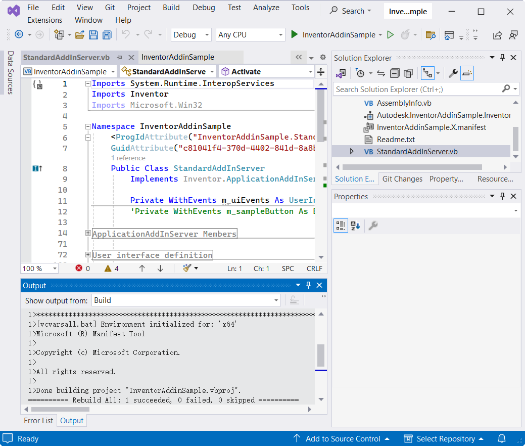

Recompile the project:

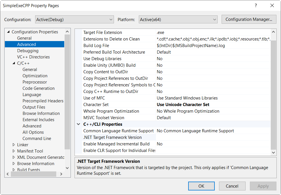

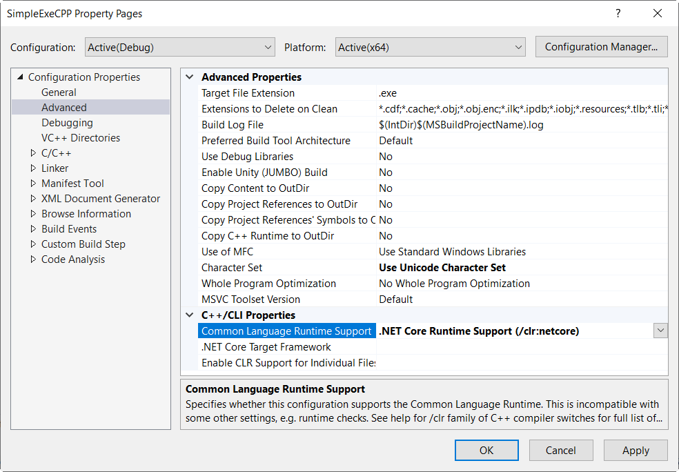

Navigate to Advanced:

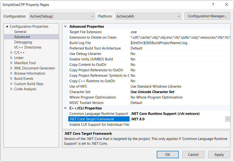

Change the Common Language Runtime Support to .NET Core Runtime Support (/clr:netcore) from the dropdown list, then click Apply button:
Change the .Net Core Target Framework to .NET 8.0 from the dropdown list, and click OK button:

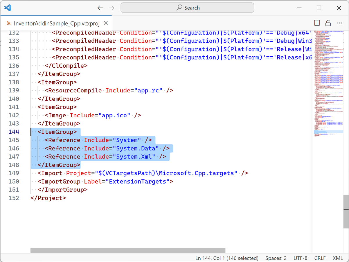

Open the project file using text editor, delete the system references:

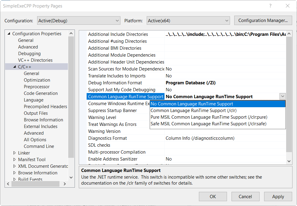

Navigate to project properties page, and go to C/C++->General, and choose No Common Language Runtime Support for Common Language Runtime:

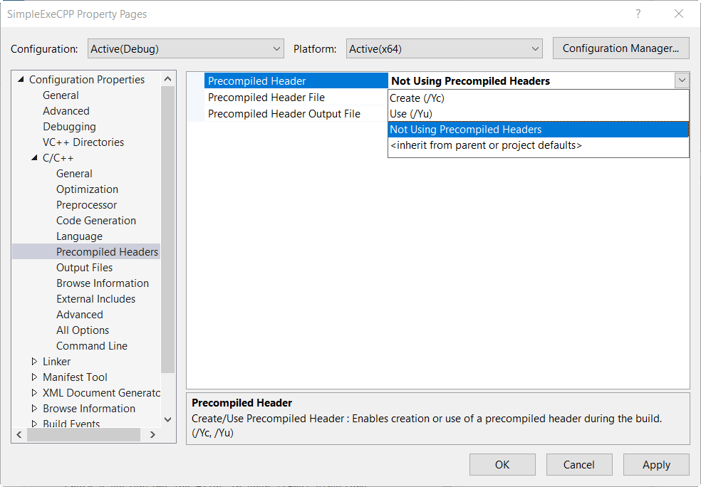

Navigate to Precompiled Headers, choose Not Using Precompiled Headers for Precompiled Header:
