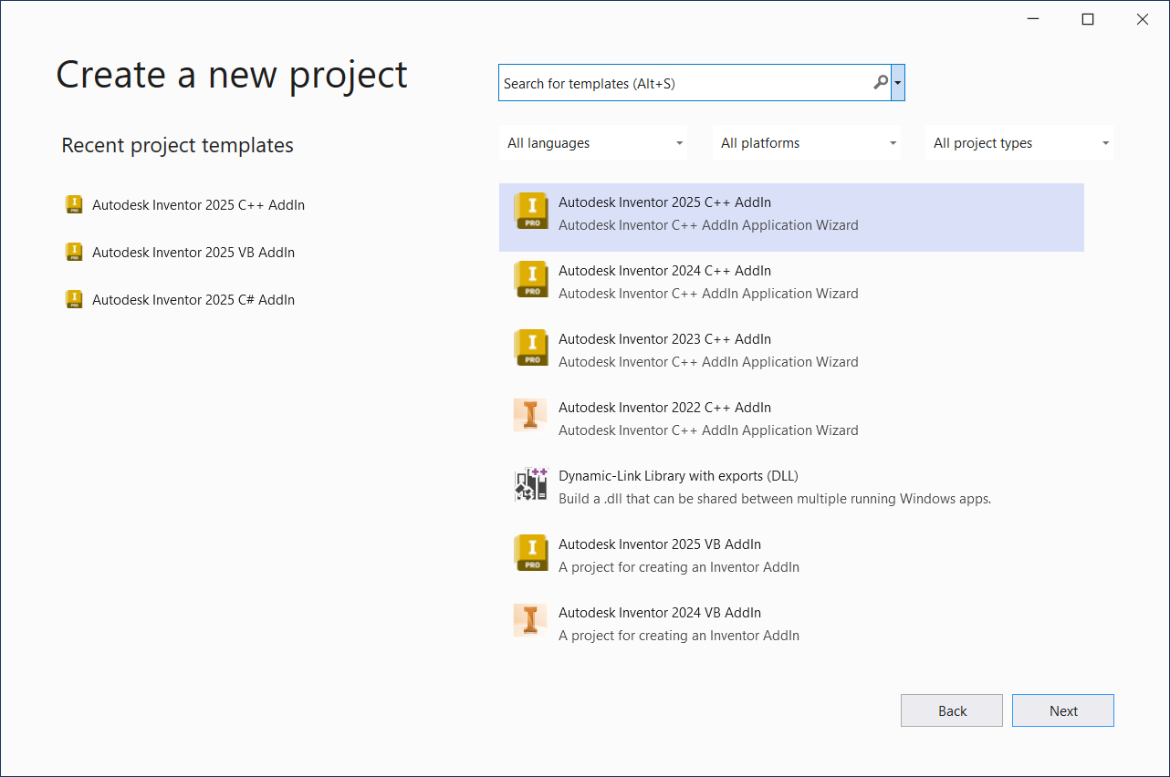

For the next step, use the Inventor Add-In template in Visual Studio to create your add-in. In order to use the add-in template you'll need to install the SDK DeveloperTools.msi. The location and installation instructions for the SDK is described in the Introduction to Using Inventor's Programming Interface overview.
With the add-in wizards installed, you can create a new project in Visual Studio selecting the Autodesk Inventor * AddIn template as shown below. On the creation dialog you should choose "All*" the the filters to see all of the available templates(custom templates are not displayed for specific filter).

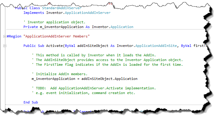

The project that's created using the template is a skeleton add-in. When Inventor starts your add-in it begins by calling the Activate method, which is shown in the picture below. A critical thing happens in this call, an object is passed to your add-in through the addInSite argument of the Activate method. This object supports an Application property which your add-in can use to gain access to Inventor's Application object and the entire API. You'll notice that the template is assigning the reference returned by the Application property to a local member variable so the add-in can maintain a reference to the Application object. It's also typically in the Activate method where your add-in will add its user interface to the Inventor's user interface using Inventor's API. It will also connect to any events that it needs to monitor. Once it's been loaded and is running the add-in doesn't do anything except react to events as they occur. For example, it would respond to the click when the user clicks one of its custom commands.
To quickly test that the use of the add-in template resulted in the creation of a working add-in you can compile the project as-is. This will compile your add-in as a dll. The next step is to make your add-in known to Inventor.

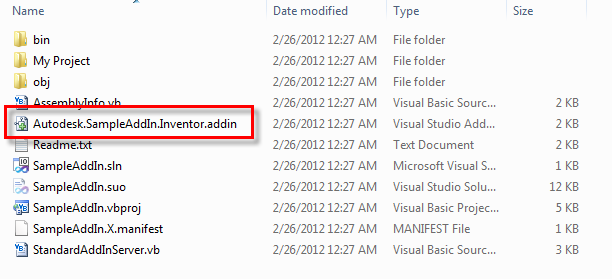

In order to allow your add-in to be found by Inventor, you need to place a special file in one of a few different directories. This file describes your add-in and also indicates where your add-in dll is on the computer. When Inventor is started, it scans these directories and reads these files to determine which add-ins should be loaded.
The file that Inventor looks for has a .addin extension. A .addin file was automatically created for you when you created your add-in project, as is illustrated below.

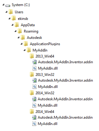

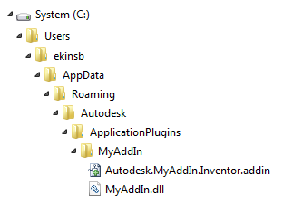

Drag and Drop Add-In Deployment
A new feature added in Inventor 2013 is the ability to create an add-in that can be deployed by simply copying a directory into a certain location on the user's computer. The change made to enable this is that Inventor looks in the four directories above for .addin file and now also looks in any subdirectories within those four directories. If you create a directory that contains your .addin file and your addin dll and set the Assembly element of your .addin file to have just the name of your dll without any path, you can copy that folder to any of the folders above and Inventor will find and load your addin. Below is an example of the directories and files for an add-in named "MyAddin". This shows the full path for the "%APPDATA%\Autodesk\ApplicationPlugins" location.
It's also possible to create much more complex configurations for a drag and drop type of add-in. For example you can have an add-in where you have one dll for 32-bit and another one for 64-bit. You might also have a dll that is specific to a certain version of Inventor and a different dll for another Inventor version. The possible directory structure to support this is shown below. In order for it to support multiple versions of Inventor you must put the folder in one of the two version independent folders. An example of how the folders might look for an add-in like this is demonstrated in the picture below. What's happening here is that you are essentially delivering four different add-ins, each with their own .addin file and dll. Which version and which OS the add-ins load is controlled by the contents of the .addin file for each of the add-ins.

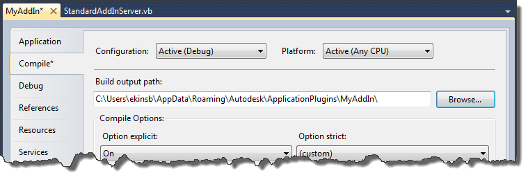

  2. You need to change setting in your project so that when you compile your project, the dll is output to the directory above. This is so Visual Studio and Inventor will be using the same dll. The project setting to change is shown below.

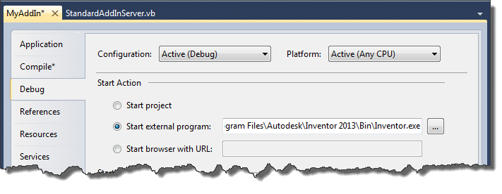

  3. You need to set the debug setting so that when you start your project from Visual Studio it will automatically start Inventor. The project setting to change is shown below.
Now you can add break points to your add-in and begin debugging (F5) from Visual Studio. Inventor should begin running and your break points should be hit when those lines are executed.
