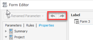

Undo, Redo options in the iLogic Form Editor
The Undo and Redo buttons are now added directly to the Form Editor dialog. You can also use the shortcut keys (Ctrl-Z and Ctrl-Y) for these operations.
