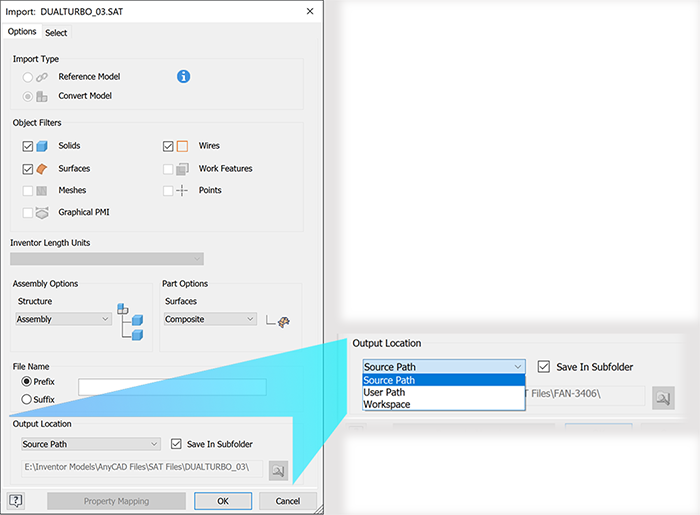

Import Workflow Improvements
With this update you can specify the Output Location, where files are stored, for import tasks. Select the location using Source Path, User Path, or Workspace. The option to Save In Subfolder improves file management tasks. The path selection persists for use with subsequent import tasks, whether a single file or a batch process.
For more information see To Import Files as an AnyCAD Reference or Convert Model.
