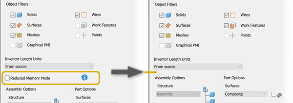

Reduced memory mode is removed from the Import dialog.

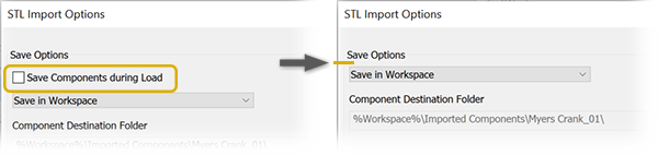

For OBJ and STL import, the option to Save Components during Load is removed.

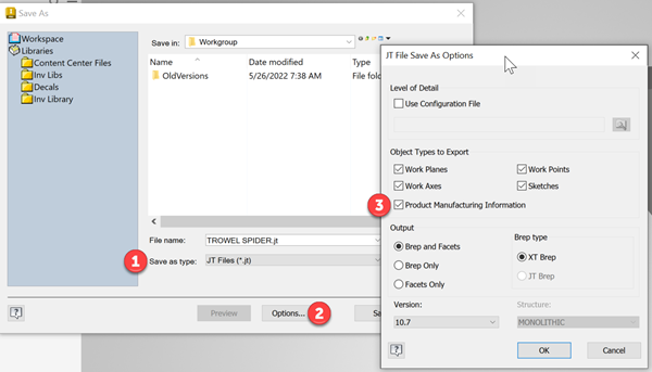

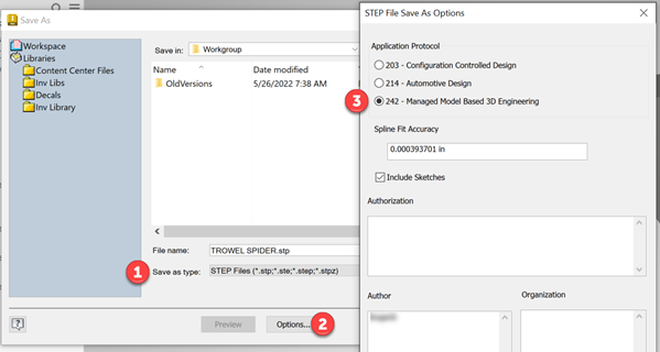

PMI, in part documents, can be included when exporting assemblies in JT and STEP formats by selecting the option.
  • JT format.
  • STEP AP 242 format.
