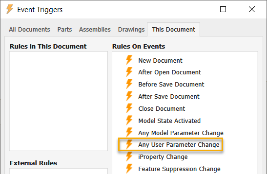

There is a new event called Model State Activated now available in the Event Triggers dialog box. This trigger occurs when a model state is activated. Use this trigger to run a rule in the document in which the event occurred.

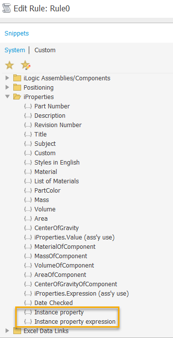

iLogic Support for Instance Properties
Use the new Instance property snippets to read and create Instance Properties.
For information on snippets in iLogic, see About Code Snippets in iLogic.
iLogic Support for User Parameter Change Event
There is a new event named Any User Parameter Change in the Event Triggers dialog box. This event is triggered when you change the value of a User parameter.
For information on Triggers in iLogic, see To Work with Event Triggers in iLogic.

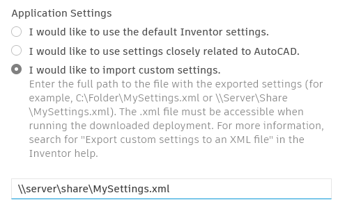

iLogic Deployment Enhancement
You can now create a deployment that includes your customized settings in the iLogic Configuration dialog box.
| In the Application Options dialog box, click Export. Export saves the current Application Options and the settings in the iLogic Configuration dialog box to an .xml file | When creating your deployment, select I would like to import custom settings, and enter the path to the exported .xml file |
