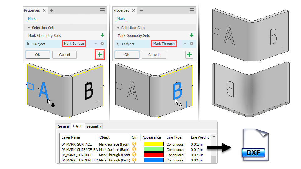

.- Select Mark Surface to apply the mark to a single face and to outline the text.
- Select Mark Through to apply the mark to multiple faces and to convert text characters to a single stroke path based on the selected font.
Select the sketch text or geometry. If no sketch exists, you are prompted to select the face where the mark is to be placed, then, a sketch is activated on that face.
Optionally, click Add Mark set
and continue to select text or sketch geometry. You can set Mark Surface or Through for each member.Specify the feature Behavior, choosing either Project or Wrap.
Projects the sketch geometry to a face. Select this method and the desired direction option.
Wraps the sketch geometry to a cylindrical face. Select this method and the target face.
Click Apply
to continue to use the Mark command or click OK to finish.

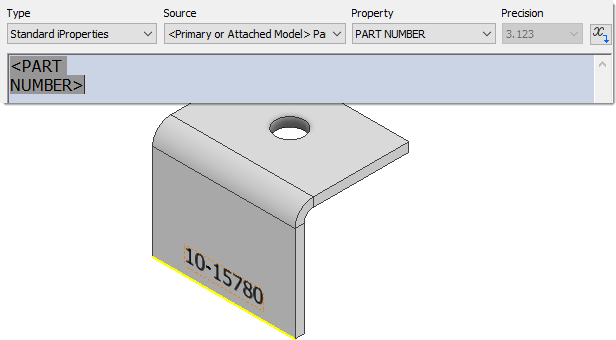

You can use iProperty values in sketch text to create Mark features that are associative to the iProperty value.

Export Mark feature layer information
To export a Mark feature with DXF/DWG layer information:
- Create a sheet metal part with one or more Mark features in the folded model or the flat pattern.
- Create a flat pattern.
- Right-click the Flat Pattern in the browser and select Save Copy As in the context menu.
- Enter a File name and choose DXF or DWG in the Save as type value field.
- Click Save.
- In the Flat Pattern DXF/DWG Export Options dialog, click the Layer tab.
- Scroll to the Mark feature layer names and make any desired changes.
- Click OK to finish.
