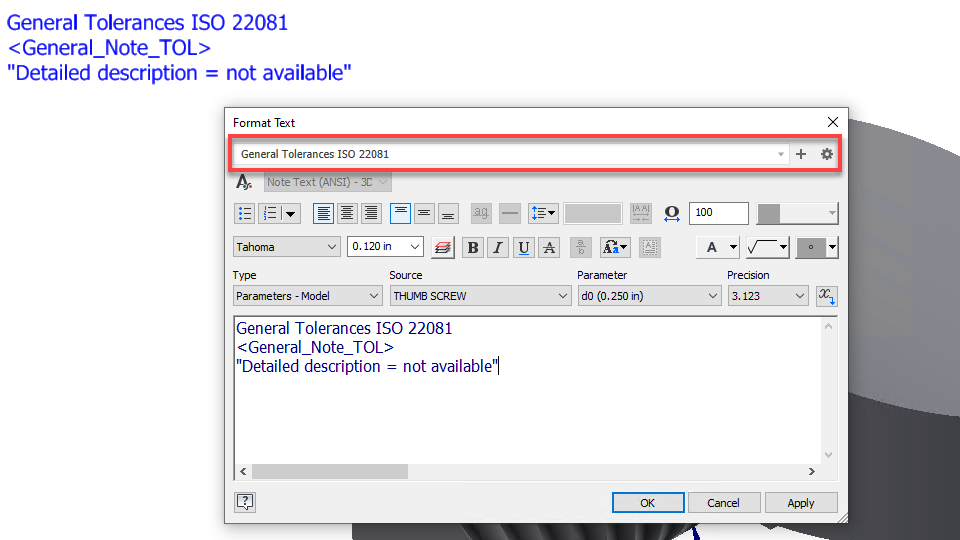

You can use presets in General Note and General Profile Note commands located in the General Annotation panel.
Preset can contain:
  • Text
  • Symbols
  • Parameters
  • Standard iProperties
  • Physical Properties
Presets for General Note and for General Profile Notes are not shared, separate presets need to be created for each. However, presets for General Notes are shared between both parts and assemblies.

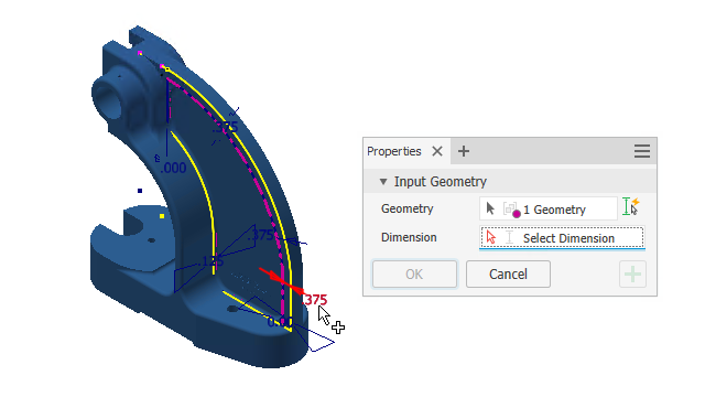

Promote Dimensions
In both parts and assemblies, you now have the ability to create 3D annotation dimensions directly from the dimensions of the selected sketch or feature using the newly added "Promote Dimensions" command within the Annotate tab.
Select a feature or a sketch to enable the dimensions, and then select the dimensions you want to promote.
For more information see To Promote Dimensions.
