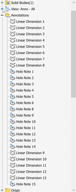

3D Annotations
You can now reorder 3D annotations in the model browser.

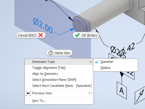

Diameter and Radius Dimensions
When creating or editing 3D annotations, you can change a diameter dimension to a radius dimension or a radius dimension to a diameter dimension. You can select multiple dimensions of the same type and change them in one action.
For more information see About 3D Annotations and Model-Based Definition.

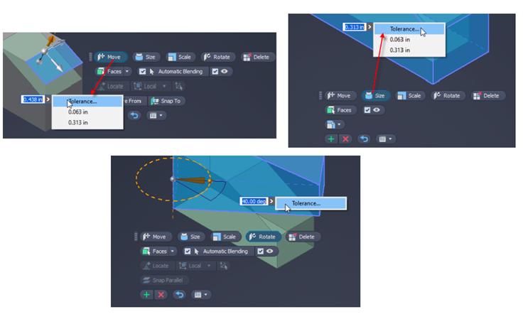

Tolerance Enhancement
You are now able to set the Tolerance when directly editing features as the option is added to the context menu for Move, Size and Rotate.

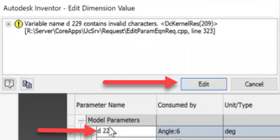

Ability to change an invalid parameter name
If the name of a parameter is invalid (for example using a space or comma), the warning dialog now contains an Edit button which enables you to correct the name directly. Previously, you could only discard the edits and start again.
