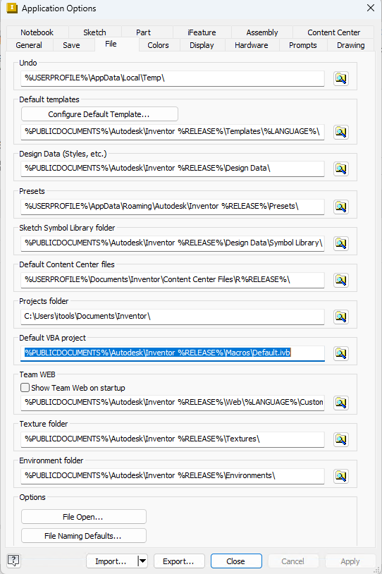

So far, all of the behavior we have discussed makes it appear that application and user projects are the same. This is largely true, but the key difference between them is how they get loaded into the VBA environment. Inventor loads the application project automatically whenever the user starts Inventor. This makes macros within an application project always available. Only one project can be defined to be the application project. The project file that serves as the application project is defined using Inventor's Application Options dialog, as shown below. The "Default VBA Project" field on the File tab defines which user project to use as the application project.

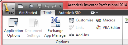

Inventor's VBA interface is accessed within Inventor by through the VBA Editor command in the Tools tab of the ribbon. The Macros command lets you run existing macros and open the editor to a specific macro. The two commands are also available using the Alt+F8 and Alt+F11 keyboard shortcuts.

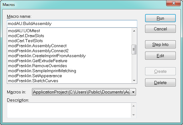

Running the Macros" command in Inventor displays the dialog shown below. This dialog displays a list of all of the macros currently available. This list can be filtered using the "Macros in" combo box. This allows you to list the macros contained in a particular project (document, user or application project), or to list all of the macros in all of the loaded projects.
When a macro is selected from the list, all of the buttons on the right, except one, are enabled. The following describes the behavior of each of the buttons.
Run - The selected macro is executed without displaying the VBA programming environment.
Cancel - Dismisses the dialog.
Step Into - Opens the VBA programming environment and begins running the selected macro by stepping into the function. This is useful when debugging a macro.
Edit - Opens the VBA programming environment with the cursor positioned at the top line of the selected macro.
Create - If an existing macro is selected, this button is disabled. If a new name is entered into the "Macro name" field, this button becomes enabled and when clicked will cause a macro of the specified name to be created.
Delete - Deletes the selected macro. This will remove the sub from the project.

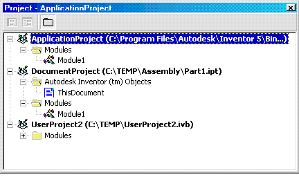

Running the VBA Editor command in Inventor opens the VBA programming environment. This is commonly known as the "Integrated Development Environment" or IDE. Within the VBA IDE is the "Project Explorer" which provides a browser-like view of the currently open projects, as shown below.
Several important concepts of Inventor's VBA integration are illustrated in the Project Explorer. The first of these is the "Application" project. As discussed earlier, this is a project file that is stored in an external file and is loaded automatically whenever Inventor is run. The name of the project file is shown in parentheses next to the project's name.
The second project in the list is a document project. The name of the document in which the project is embedded is shown in parentheses next to the project's name. Document projects are shown for the documents currently open in Inventor. One difference between user and document projects that's apparent when looking at the Project Explorer is that the document project exposes the "ThisDocument" object. This represents the document that contains the macro. Writing code within the ThisDocument module give you direct access to the Inventor document. For example, the following code is valid within the ThisDocument module.
