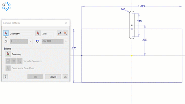

  • Sketch Pattern Enhancements
    You can now use a sketched boundary and pattern sketch geometry only within that boundary. You determine which geometry is used in the pattern, such as only within the boundary, all with centroids inside the boundary, or by using a base point where all geometry with base points inside the boundary are used.
    For more information about sketch patterns, see To Create and Edit Sketch Patterns.

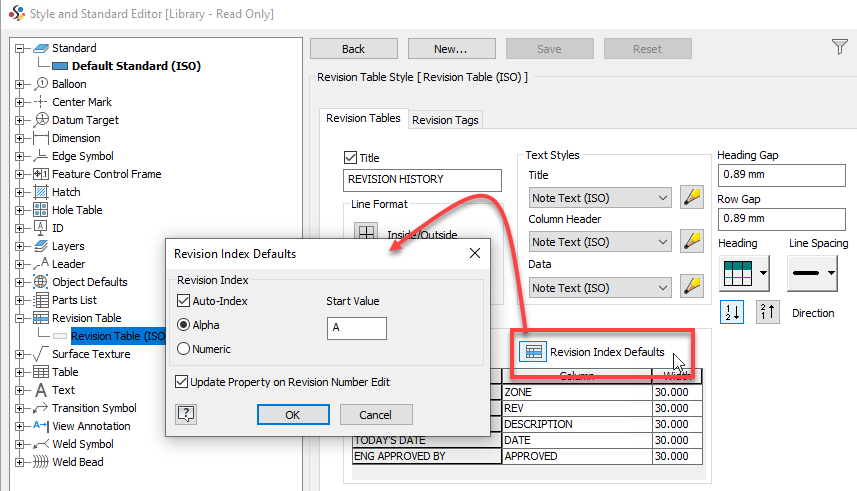

  • Revision Index Settings for Revision Tables
    It is now possible to specify default numbering (alpha or numeric) from within a drawing template instead of via the revision table itself. A new "Revision Index Defaults" option has been added to the "Style and Standard Editor" for Revision Tables.
    For more information see Style and Standard Editor - Revision Table Style Reference, Revision Table Reference.

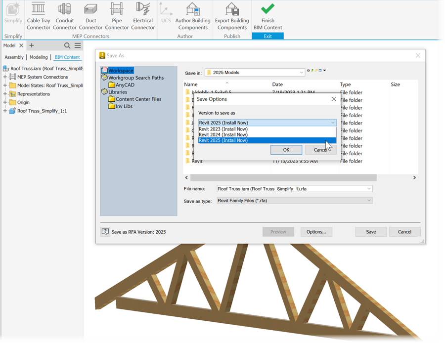

Revit Interoperability
Output to Select Revit Versions
You now have the ability to export to Revit 2023 and newer versions. If the matching Revit Core Engine (RCE) isn't installed you are prompted to install it. As the installation proceeds you can work in Inventor doing other tasks. When the install is complete, restart the command you used before the installation.
Note: Valid only for files saved to Revit 2023 and newer versions.
The Revit versions feature is added for the following commands:
  • Simplify
    When using the Simplify command to export Revit (*.RVT) flies, select the version from the drop down list.
    For more information see To Export a Model to RVT (Revit format).
  • Export Building Components
    When using the BIM Content Environment to output RFA files, click the Options button to access the Revit versions list.
    For more information see To Export Building Components.

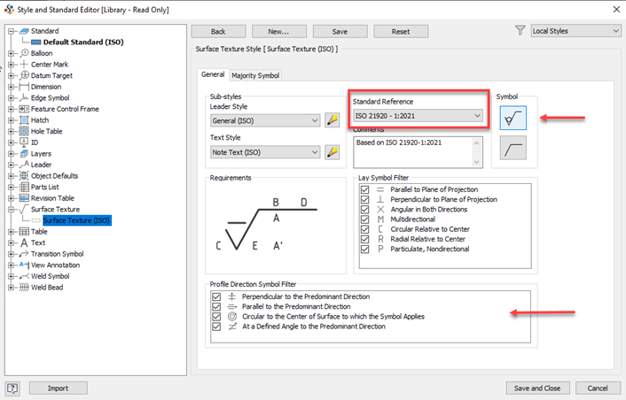

  • Surface Texture
    You now can define Surface Texture Symbols based on the ISO 21920-1 standard.
