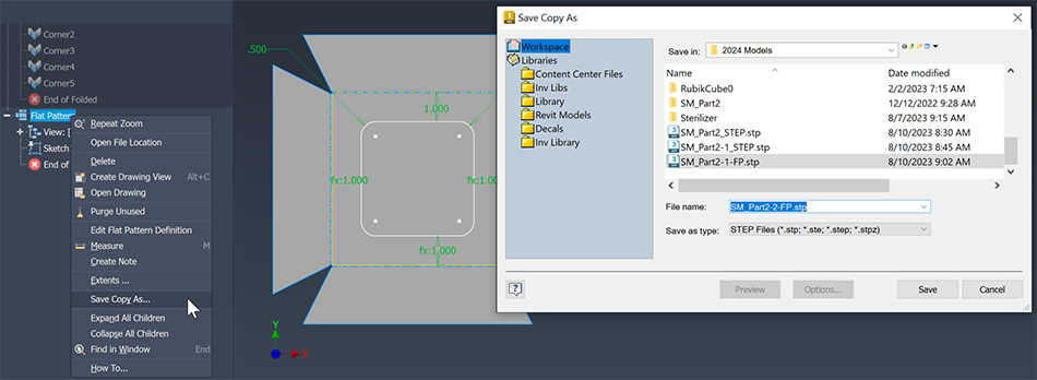

Flat Pattern
Output sheet metal flat patterns in STEP format. The output is a simple solid model. Flat pattern sketches can be included in the output and must be visible for the export. Save Copy As is available whether or not the flat pattern is active.
For more information see [About Sheet Metal Flat Patterns](topicid=About Sheet Metal Flat Patterns) and To Work with Flat Pattern in Sheet Metal.
