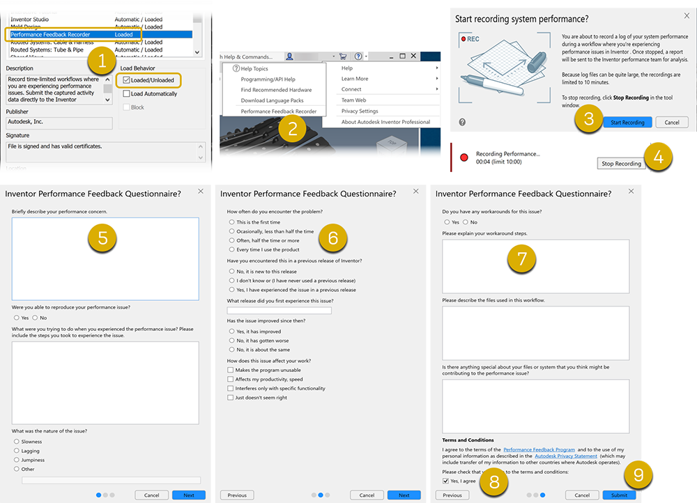

With the Performance Feedback Recorder loaded, you can activate the recorder and demonstrate a performance issue and then turn that information in to the Performance team for review and .
What's New: 2025
Manage the add-in
Access: In the Ribbon Tools tab Options panel, click Add-ins.
The recorder has a 10 minute time limit.
  1. In the Add-ins dialog, select Performance Feedback Recorder and under Load Behavior, click Loaded/Unloaded.
  2. In the Inventor Title bar, expand Help and click Help Performance Feedback Recorder. The tool displays.
  3. In the recorder, click Start Recording.
  4. When you've demonstrated how you encountered the issue, then, click Stop Recording.
  5. In the Questionnaire, provide a brief description of the concern and the experience information.
  6. Select the appropriate input to describe the frequency, Inventor release used, and some scope information.
  7. Provide any workarounds you developed or had to do to get beyond the concern.
  8. Read the Terms and Conditions, check the box if you agree. The Submit button enables.
  9. Click Submit and the information you provided and the diagnostic files are sent to the Performance Team.
