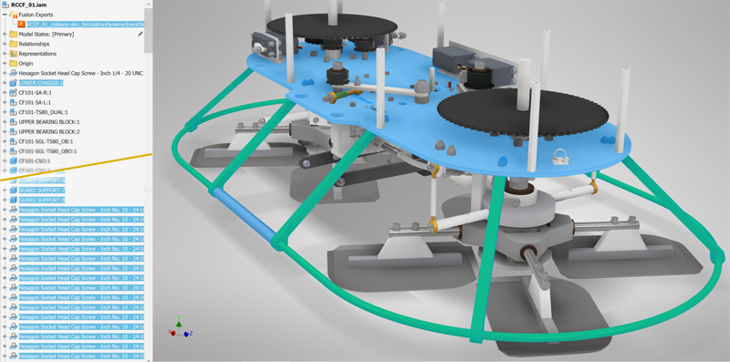

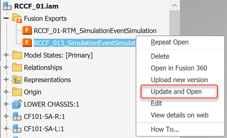

Fusion Exports
Models sent to Fusion 360 have a browser node in the Inventor Model browser > Fusion Exports folder. With this release you can update and open the model in Fusion 360 with one click. In the browser node context (right-click) menu, click Update and Open.
To view the components included in a Fusion Exports dataset, select the browser node in the folder, the included components highlight in the browser and canvas.
