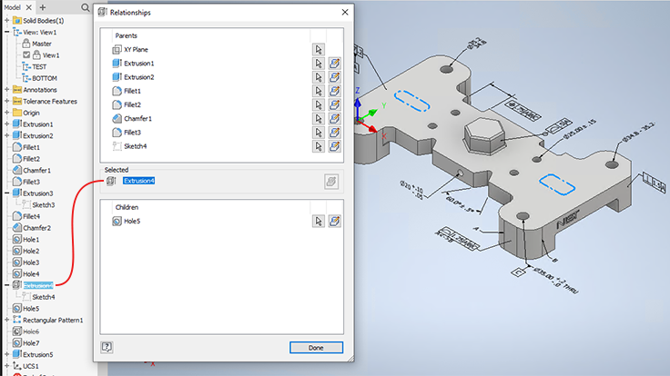

Part Feature Relationships
The Relationships command now works for suppressed features. Right-click a suppressed feature and select Relationships.
For more information see To Find Relationships in Part.

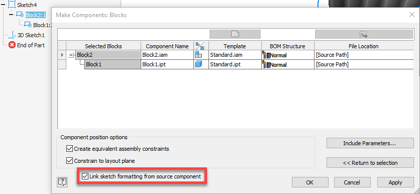

Link sketch format from source component
A new "Link sketch formatting from source component" option is added to the Derive dialog. It enables to control if the sketch blocks in the derived part update if the lines in the source part are changed.
The local sketch format option is disabled if a selection in a derived sketch only contains derived geometry. The format option is enabled if a selection in a derived sketch contains a mix of derived and non-derived geometry and updates are only applied to non-derived geometry.

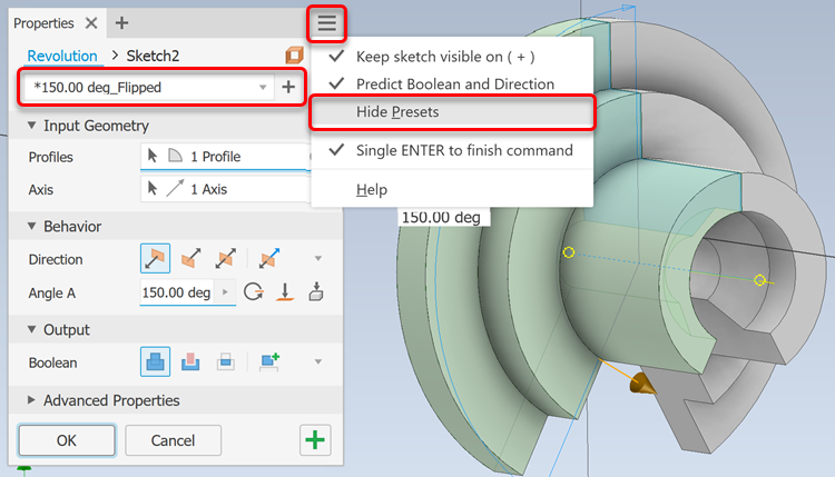

Extrude and Revolve Enhancements
All Property panel options are now preserved in the presets.
For more information about property panel Presets see To Work with Presets.
