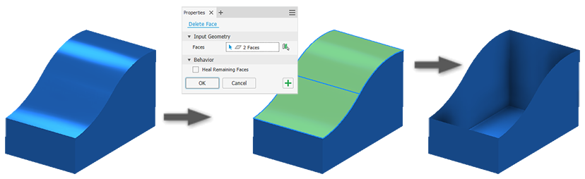

Delete Part Faces
  1. Click 3D Model tab Modify panel Delete Face .
  2. The Faces selector is active when the command starts.
    • Select one or more faces to delete. You can preselect the faces and activate the command.
    • Click the , and in the graphics window, select individual faces, lumps, or voids that you want to delete.
      Tip: Click-drag a crossing window to do a multi-select operation.
  3. (Optional) When deleting individual faces, select Heal Remaining Faces to heal gaps by extending adjacent faces until they intersect.
    Note: The Heal Remaining Faces setting is remembered for the next time you use Delete Face.
  4. Click OK to complete the task or Apply if you want to continue using the command.
For information about using property panels, see About Property Panels.
