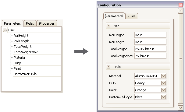

About Forms
Create and connect a custom user interface to the parameters, properties, and rules of an Inventor part, assembly or drawing document.
Use drag and drop methods to design a user interface with no need for programming. Use the controls to drive changes to an existing design. Form definitions can be document specific and saved with a design document or stored for use across multiple documents.
