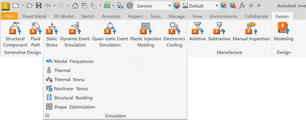

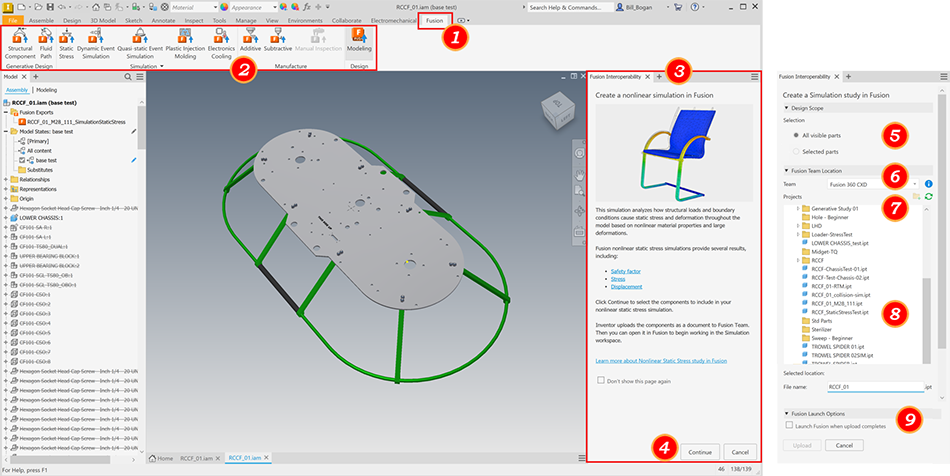

  1. When your model is ready and in the appropriate model state, in the Part or Assembly environment, click the Fusion tab. Available tools enable based on the document type.
  2. In the ribbon, click the study or process that you want to use to get design.
    Note: Inventor supports preselection of bodies for this process. Change the Selection Priority to Part Priority, then select parts.
  3. The Fusion Interoperability panel displays an introduction page. The page explains the purpose of the selected command and may provide links to examples and learning content. You can opt to not show the page and go directly to the details page.
  4. Click Continue to go to the next panel where you make selections and specify the Fusion web client to use.
  5. For assembly models, in the Fusion Interoperability panel, for Design Scope, specify whether you are using:
    • All visible parts - this is a good time to use a prepared model state. If the instance count exceeds 500, you are prompted to remove some parts to reduce the amount of data being sent to Fusion. In addition to the visible parts, the following items contribute to the instance count:
      • Non-visible parts - hiding does not eliminate parts from the count. Parts must be suppressed to be not counted.
      • Reference parts
      • Disabled parts
      • Active model state
      • iAssembly includes only the current instance
    • Selected parts - activates a selector so you can pick the parts you want to use.
      Note: If you've defined a model state, you may not need to select parts individually.
      Note: If components are pre-selected when a command is activated, the selected parts are included. You can continue to select additional parts. Selection can occur at any time prior to clicking Upload.
  6. Select the Fusion web client Location for the uploaded Inventor data. The selected location displays below the Projects list.
  7. In Projects tree view, select the project folder where the data will be stored.
    • You can add new folders to Fusion web client. Click and name the folder.
    • If the project data or folder organization has changed, click the refresh button to update the displayed information.
    Note: If you are the project owner, you can give collaborators permission to view or edit the contents of any folder, on a folder-by-folder basis. For more information about managing Fusion project access see Manage people in projects.
  8. Specify the file name or accept the default which is the active model name. If a name is already used, the specified filename is appended with an index number.
  9. Optionally, select Fusion Launch Options. These options activate after the data uploads to Fusion web client, you can:
    • Click View Details on Web to open in Fusion web client.
    • Click Open in Fusion to continue to work on the data in the appropriate workspace. In Fusion, you can display the Learning Panel (right panel) to provide guidance for the steps through the study or process.
  10. Click Upload to send the data to Fusion web client. You are prompted to save the Inventor file. Once saved, a Fusion folder is added to the Inventor browser and a node linked to the data is instanced in the folder.

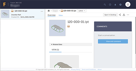

    The Inventor IPT is visible in Fusion web client. When opened in Fusion an associated .F3D file is generated.

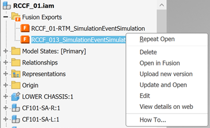

Later, when the Inventor model changes, you can update the linked model and rerun any studies with the updated data. To view the components included in a Fusion Exports dataset, select the node in the folder and the components highlight in the browser and canvas.
From the browser node context menu, you can:
  • Delete the node, breaking any association or link to the Fusion version of the data.
  • Open in Fusion opens the Fusion model in the workspace associated with the command that created the node. If the model has changed since the send to Fusion action, you are notified that the Inventor model and Fusion export are out of sync. You have the option to update to the Fusion model before opening it.
  • Upload new version creates a new version of the Inventor IPT using the current model view and model state. Open the updated model in Fusion to generate a new F3D. Studies are not automatically re-run. Enables only if changes have been made to the model.
  • Update and Open updates the selected Fusion model and opens it in the appropriate Fusion workspace. Enables only if changes have been made to the model.
  • Edit - see below.
  • View details on web opens Fusion web client in with the Fusion data as the focal point.
