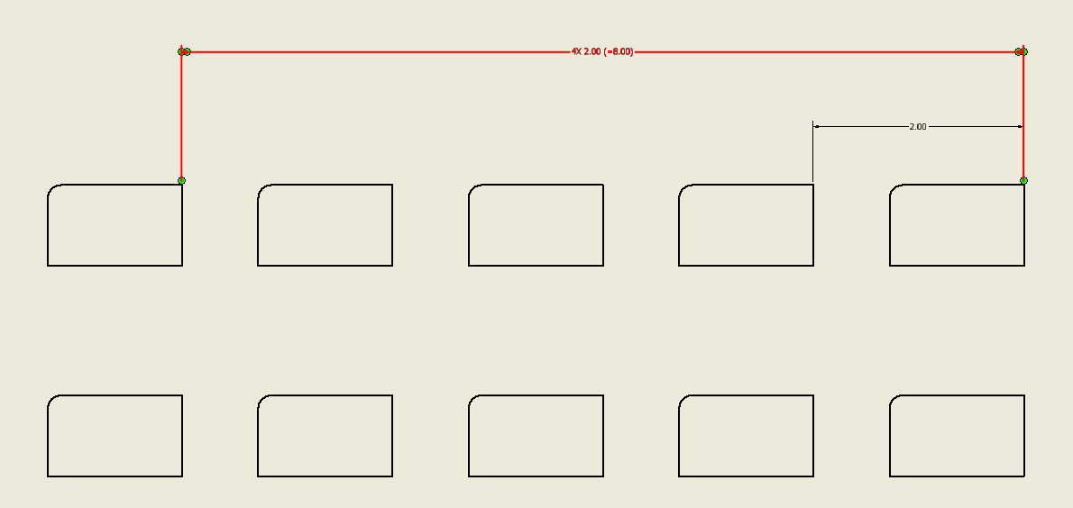

New GeneralDimensions.AddAngularSum and AddLinearSum methods that allow to add angular and linear sum dimensions in drawing document.

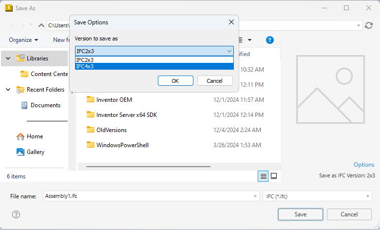

Support new version type(IFC4x3) when export to IFC file using BIMComponet.ExportBuildingComponentWithOptions.

| AngularGeneralDimension.SpacingDimension | Gets and sets spacing dimension for the angular sum dimension. |

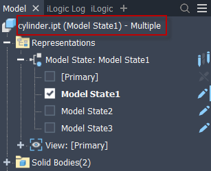

| AssemblyDocument.DisplayNameBasis | Gets and sets the display name basis of this document. This defaults to file name. |
| AssemblyDocument.FullDisplayName | Read-only property that returns the full display name of this document. |
| BIMComponent.ExportBuildingComponentWithOptions | Method that exports the BIM component as an adsk, ifc or rfa file. |

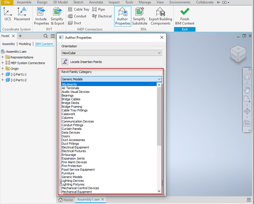

| BIMComponentDescription.RevitFamilyCategory | Read-write property that gets and sets the Revit family category Id. |

| DimensionStyle.ExtendBeyondTicks | Gets and sets the distance extend the dimension line past the extension line in centimeters when the arrowheads is specified as oblique or no marks. |
| DimensionStyle.ExtensionLine | Gets and sets the length of the extension line in centimeters. |
| DimensionStyle.UseCapitalXForEquallySpacedFeatures | Gets and sets whether to use capital X for equally spaced features or not. |

| FileManager.GetRevitFamilyCategories | Method and returns an array of string that contains the names of Revit family categories. |
| FileManager.GetRevitFamilyCategoryIds | Method and returns an array of Long values that contains the unique Ids of Revit family categories. |
| FileManager.GetRevitFileVersionCreated | Method that returns the Revit version that the Revit file was created with. |
| FileManager.GetRFAFamilyCategories | Method and returns an array of string that contains the names of RFA family categories. |
| FileManager.GetRFAFamilyCategoryIds | Method and returns an array of Long values that contains the unique Ids of RFA family categories. |
