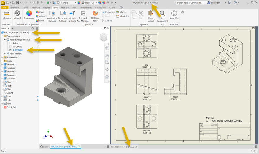

Note: Actually, this enhancement was implemented in Inventor 2026, but we missed telling you about it.
In Application Options there is now a control for the visibility of the active model state label throughout the user interface. When selected the label displays, deselected and the label is hidden. This enables you to control the amount of information you want to see.
For more information see About Model States.
