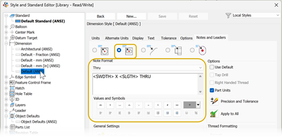

To accompany the new slot feature, the drawing styles now include Slot parameters in Dimension styles, Hole Table styles, and Center Mark styles.

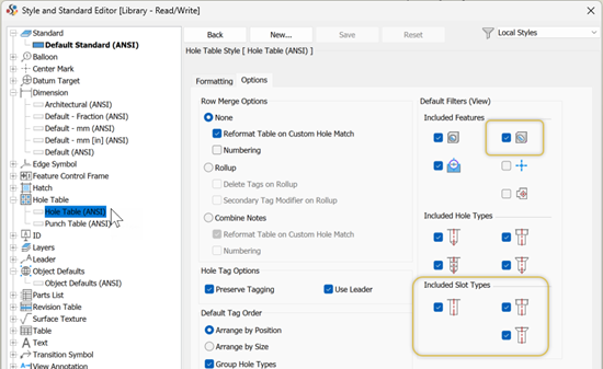

Hole Table enhancements include the following:
  • Slot Note Dimension Style
  • Hole table style
    The hole table now supports slot features. When enabled in Hole Table Style settings, slots are included in the table with coordinates referencing the slot center and a 'Slot Note' description.
For more information see To Specify the Hole or Slot Note Format

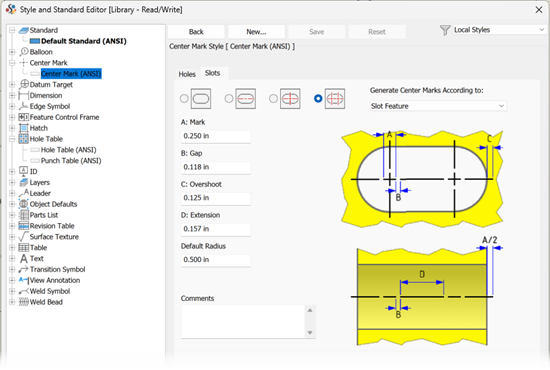

  • Center Mark style
For more information see To Specify the Center Mark Style
