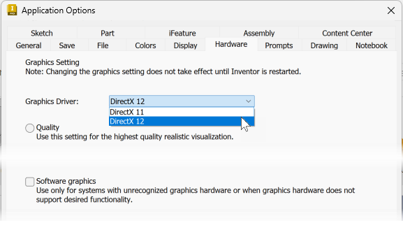

DirectX 12 Support
With this release, Inventor will use DirectX 12 (DX12) for graphics. You can return to using DirectX 11 using the Application Options Hardware tab.
Note: Inventor must be closed and restarted for hardware support changes to take effect.
If DX12 is supported by the machine hardware, Inventor will default to using DX12.
AppOps-Hardware

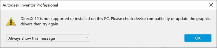

Depending on the machine configuration one of the following messages may display:
  • DX12 is not installed or may not be supported
    dx12 not installed

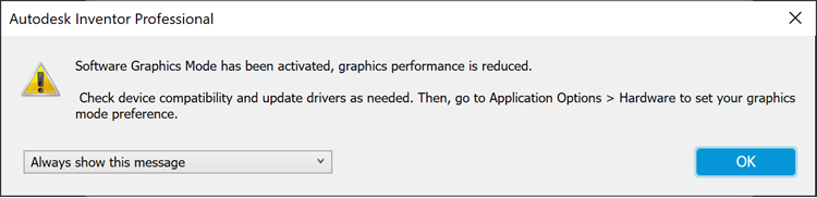

  • Hardware doesn’t support either DX11 or DX12
    Software graphics mode

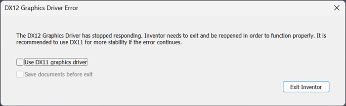

  • For cases where the DX12 driver isn't sufficiently robust
    DX12 driver
