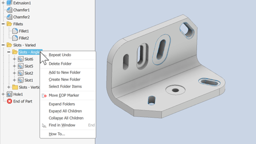

Folders
Part browser folder]
With this release, Part Browser Folders are added. Right-click a feature and select Add to New Folder. The new folder is created and the selected feature placed in the folder.
Folder Management
Part Folder commands
Manage part folders using the right-click menu commands.
