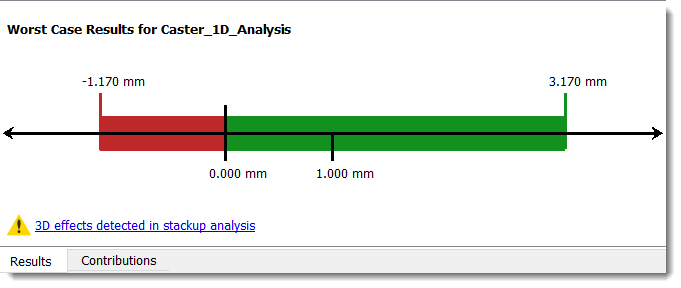

When Tolerance Analysis detects that the geometry included in the study is influenced by more than a single linear direction, the 3D effects detected in stackup analysis warning is displayed. The notification means that the results may underestimate the variation that will occur during production. If you see this message, you should think about the geometric relationships between the parts to determine if you need to perform additional analysis.

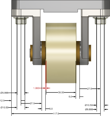

The analysis in the following image appears to be similar to the previous example, but there are conditions that can impact the translational 1D tolerance, so a warning is displayed.
Specifically, the tolerance analysis on the caster assembly accounts for all the vertical faces, but it does not account for potential variation in the top horizontal mounting faces. The warning alerts you to consider the influence of the other parts.

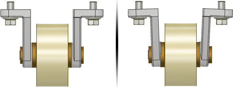

The following image shows an exaggerated example of what happens when the horizontal mounting faces rotate through their tolerance zones. The vertical legs of the brackets are no longer parallel to the wheel causing compression.
The warning typically calls attention to scenarios where the rotational variation of a surface has significantly more impact than the translational variation through the permissible tolerance limits. Because rotational effects are not included in the calculations, the warning alerts you that rotational effects may exist. The warning enables you to assess the severity of the requirement and determine if you need to use a 3D tolerance analysis tool or manually calculate the impact of the non-1D contributors and subtract the error from the acceptable stackup limits.
