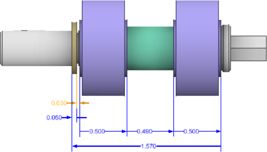

A 1D tolerance stackup means the distance being analyzed and all dimensions that contribute to the distance variation are acting in the same linear direction. Linear variation of the surfaces on either side of the stackup direction is considered; angular variation of the surfaces relative to each other is not. Sometimes the effects of angular variation are overlooked, and the analysis is considered to be 1D. However, when significant differences exist in the size of the surfaces included in the stackup, angular variation on smaller surfaces can have a greater effect on the edges of the larger surfaces. If larger surfaces follow the orientation of the smaller surfaces, they move back and forth in the direction of the analysis by more than the simple translation of the surfaces would permit. Tolerance Analysis warns you when this scenario, and others with similar effects, is detected.
In a 1D problem, the sensitivity of the overall stackup distance to each contributing dimension is usually 1.0 or -1.0 for standard dimensions. Sensitivities to size dimensions, for example, diameter or width, may be 0.5 or -0.5.

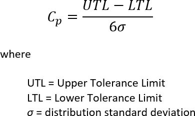

The standard deviation calculated for the normal distribution of each dimension is calculated from the following formula for Cp:
Solving for the standard deviation yields:
The most common assumption of Cp=1.0 stems from the assumption of a manufacturing process that places the defined tolerances at +/- 3 standard deviations from center of the tolerance zone, assumed to be the mean, so that the probability of a part complying to the required tolerances is 99.7%. For all statistical analyses, Tolerance Analysis assumes that manufacturing targets the midpoint of the tolerance range, therefore the mean is assumed to be the midpoint of the tolerance range.
