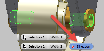

If the direction cannot be determined from the selections, such as when measuring between two cylindrical features, you are prompted to make a selection to define the Direction of the stackup.
Use one of the following to define the direction:- Plane: The outward normal vector defines the direction.
- Cylinder and Cone: The axis defines the direction.
- Linear edge: The edge defines the direction.

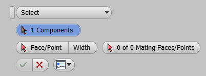

- Click the drop-list next to Assembly Constraints/Joints and change to the Select option.
Note: If the assembly does not contain any constraint or joint information, the Select option is active.
The part associated with the first feature is automatically included in the loop and the appearance temporarily changes to transparent.
- Select the part opposite the gap being analyzed that is attached to the first part. The selected part appearance changes to transparent. Continue to select parts until you have selected all parts in the loop. The last part you select is the one that contains the second feature of the gap being analyzed.
The minitoolbar displays the number of selected parts. If you select the wrong part, restart the process by selecting Components in the minitoolbar.Tip: Be sure to include alignment pins or fasteners being used to position the parts to one another. Tolerance Analysis is not able to calculate the assembly shift through these parts if they are not included in the loop definition.

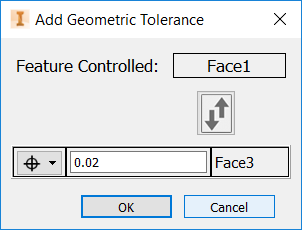

Select Geometric to open the Add Geometric Tolerance dialog box.Note: The Geometric option is not available for edges, vertices, or points.
The feature listed in the top value box is assumed to be controlled by the definition of the tolerance in the Feature Control Frame (Face1 and Face 3 in the previous image). If the order is not correct, use the toggle button
to reverse the features.
Use the drop-down at the left of the Feature Control Frame (FCF) to choose the type of control and set the desired tolerance value. Sometimes you can add a material modifier to the feature being controlled or to the datum feature. To add a material modifier, use the drop-list next to the tolerance or datum feature name respectively.
Use this workflow to make modifications to the Geometric Tolerance definition. You can change the tolerance value directly in the Stackup Details table.

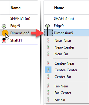

- To change the attachment of dimensions to or from features of size (cylindrical and width features), select the line to the left of the dimension in the table as shown in the following image.
When both the feature above and below the dimension is a feature of size, there are multiple options. The first indicates whether the dimension origin should be attached to the Near, Center, or Far side of the feature immediately above the dimension. The second item is for the attachment to the feature immediately below the dimension. If only one of the features is a feature of size, there are only three options in the list.

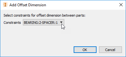

Add an Offset Between Parts
Tolerance Analysis assumes the constraining surfaces selected during the stackup loop definition are coincident, but you can use the Add Offset command to specify a distance or offset between the parts with an associated tolerance.
Uses for Add Offset include controlling the distance between parts during assembly, such as a gear on a motor shaft, or adding the thickness of a coating operation to one or both parts that are not included in the model. Specifying a negative value for the offset causes the surface of one part to extend into the surface of the other, although this is not commonly used.
Click Add Offset in the Tolerance Analysis tab > Stackup Panel. The Add Offset Dimension dialog box appears.
Click the drop-down to list all the assembly constraints defined for the current stackup. Click an entry and then click OK to add a row between two parts in the Stackup Details table with the prefix Offset. Specify a nominal value and tolerance for the distance. To remove an offset, right-click on the row and choose Delete.
An offset cannot be defined if one of the features referenced by a constraint is a feature of size. For example, a cylinder or width with an associated size dimension. Such instances are shown in a light-gray font. If all assembly constraints in the current stackup involve a feature of size, the message Offset cannot be applied to features of size! is displayed in the Add Offset Dimension dialog box and the OK button is disabled.

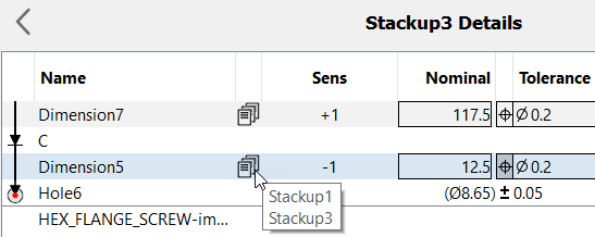

Add a New Stackup
You can create another stackup in the model by selecting New Stackup in the ribbon and repeating the previously described steps. If you include part features in a new stackup that are included in another stackup in the file, the dimension path between them is known and it is included in the new stackup. The icon shown in the following image appears near the dimension to alert you that more than one stackup includes the dimension. Hold your mouse over the icon to display a tooltip that lists all stackups that include the dimension.
If features and associated dimensions are shared by two or more stackups, you are not able to reorder any shared features that are used as a part constraint. You may also experience restrictions adding a new feature in a stackup if it is already used in another stackup. This action is a considered a reorder and should be performed in the stackup that contains the feature. These restrictions help ensure that a consistent part-level dimensioning scheme is applied to all defined stackups.
