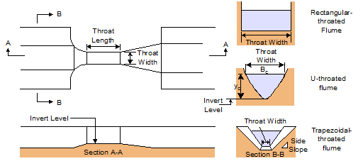

Flumes are effectively constrictions in a channel or pipe. They are usually used to allow you to make accurate flow measurements.

Invert level |
The Invert level is the level above datum of the top of the hump (assuming the flume has a hump in the throat). Hump height is then calculated as Invert level minus Upstream Invert. If the flume has no hump it is the level above datum of the centre of the throat.

Throat width |
The width across the narrow part of the flume. For trapezoidal flumes, the bed width should be used. The width of a U-shaped flume is also the diameter of the semi-circular invert. |

Throat length |
The length of the straight sided part of the throat |

Side slope |
Only relevant for trapezoidal flumes. The two sides of the flume are assumed to have equal slopes. The Side Slope is the ratio of the horizontal distance over the vertical distance. This means that a vertical side has a Side Slope of zero. As the side approaches horizontal, the Side Slope value approaches infinity. |
