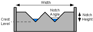

Notch height |
The vertical distance from the base (apex) of the notch to the top of the weir plate. Vee and Trapezoidal Notch Weirs only. |
notch_height |
Double |
L |
3 |
0.06 |
Notch angle |
The angle at the base (apex) of the notch in degrees. This means the full angle, not the angle of side slope. Vee Notch Weir only. Note: This angle is calculated automatically when importing data from SWMM5. |
notch_angle |
Double |
ANGLE |
2 |
90 |
20 |
100 |
Notch width |
For Contracted Rectangular Weirs, this is the width of the single notch. For Trapezoidal Notch Weirs this is the width of the base of one notch. The weir may have more than one notch. The side slope of all notches is assumed to be 14 degrees. Contracted Rectangular and Trapezoidal Notch Weirs only.
notch_width |
Double |
L |
3 |
0.000001 |
Number Of notches |
You can have more than one vee or trapezoidal shaped notch in a weir. Enter the number here. All the notches are identical. Vee and Trapezoidal Notch Weirs only. |
number_of_notches |
Long Integer |
0 |
1 |
1 |
