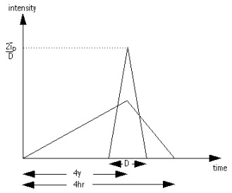

French rainfall data has never been extensively analysed for profile. Instead, alternative profiles have been suggested, including:
- rectangular: assumes that the rain falls at constant intensity over the duration, D
- double triangular: consists of a symmetrical central triangle with base duration D. The peak intensity is twice the average intensity over the duration D (which is strictly between 15 minutes and 1 hour).
The second triangle has a fixed duration of 4 hours. The average intensity of the rainfall through the four hours, including the profile made by the first triangle, is as defined by the equation above.
The peak rainfall for a 4 hr triangle occurs at the same time as the peak rainfall for the shorter storm of duration D. Therefore the triangle for the 4 hr storm is normally skewed. It only remains to decide when the peak of the rainfall occurs, namely at 4γ. This is at the user's discretion.
Double-triangular rainfall profile for French synthetic storms
Average intensity for duration D =
Peak intensity for duration D =
where:
D is the duration of short-term event
4γ is the proportion of time to peak of rainfall
i is the intensity
