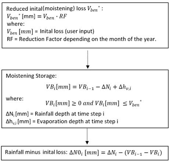

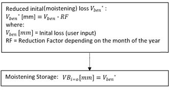

The term, moistening storage, is used to describe the amount of water required to fully moistened the ground surface at each time step. Within a continuous simulation, the recovery of the moistening storage due to evaporation needs to be taken into account. The steps for calculating rainfall minus moistening storage are shown below:
At time step i =0:
At timestep i > 0:

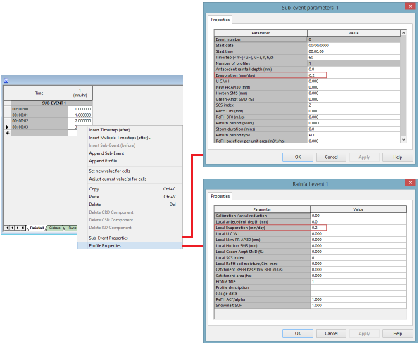

In InfoWorks ICM, the evaporation used in the DWA model can be specified in a rainfall event. If any evaporation profiles were defined on its Evaporation page, then these will be used during simulation without applying the DWA time varying evaporation factor.
However, if no evaporation profiles were defined on the Evaporation page, InfoWorks ICM will apply the DWA time varying factor, shown in Equation 2, to the evaporation rate defined for each rainfall profile in its profile properties (or the sub-event properties if you are using a global value).
Show me
Evaporation on Rainfall tab
