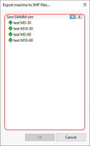

The Export Maxima to GIS dialog is used when exporting maximum results to GIS format. The dialog is used to select the simulations for which maximum results will be exported.
The dialog is displayed when an export option is selected from the Results
Export maxima to GIS submenu.
Dialog description
Option |
Description |
| Sim/SWMM sim |
A drop target for selecting the results to be exported. You can:
If you have selected any cloud simulations whose results have not been downloaded, a message is displayed informing you of this and asks if you would like to download the results now. If you select Yes, the Download Cloud Results dialog is displayed, enabling you to choose which type of results you want to download. |
| OK | Starts the export operation.
Displays a standard Windows select folder dialog so you can select the export destination folder. See Exporting Results to GIS for further details. |
| Cancel | Cancels the export operation. |
button to select a result from the displayed tree and click OK.
