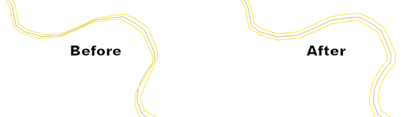

Improvements to bank line created from section ends for meandering rivers
When using the Create bank lines from section ends option, and you chose to follow the shape of the river reach link, the software now tries to project the banks out from the link line in a way that provides more natural looking bank curves whilst minimising the number of vertices used. A before and after example is shown below:
The bank is projected at a distance that is linearly interpolated from the upstream and downstream sections, with the section distance calculated as the distance between the point that the river line crosses the section and the section end point on that bank side. Projected bank points adjacent to vertices in the river line are added in a direction that is perpendicular to the river line, and on outer bends, a couple of extra beveling points may also be added to improve the shape of the curve. Contractions between banks that are too close and other "oxbow lake"-shaped meanders are simply trimmed out from the location where the banks would have intersected.
You will still need to visually inspect the banks lines to ensure they match the physical reality, and make manual changes to the bank vertices where necessary.
