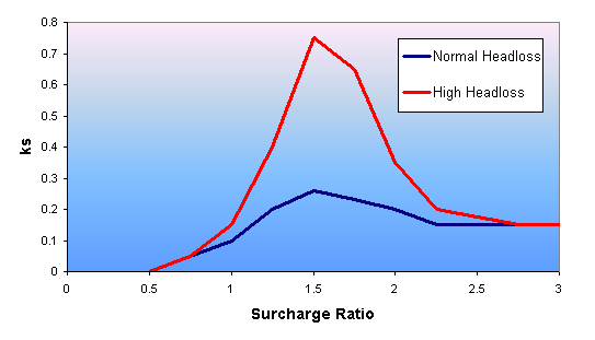

Surcharge ratio coefficient ks
The surcharge ratio coefficient defines the relationship between headloss and the depth of flow in the pipe:
Surcharge ratio = flow depth / conduit height
where:
flow depth = level in the node - invert level of pipe (immediately up or downstream of it)
The relationship between surcharge ratio coefficient ks and surcharge ratio is given by built in curves for normal and high headloss types.
Surcharge ratio Normal headloss factor High headloss factor
0.50
0.001
0.001
0.75
0.05
0.05
1.00
0.10
0.15
1.25
0.20
0.40
1.50
0.26
0.75
1.75
0.23
0.65
2.00
0.20
0.35
2.25
0.15
0.20
2.50
0.15
0.175
2.75
0.15
0.15
3.00
0.15
0.15
The normal manhole headloss is appropriate for well-constructed manholes on pipe systems, or for small open channel systems. There is negligible headloss for links flowing less than half full and small headloss up to just less than full. The actual values for well-constructed manholes are 0.001 up to half pipe full, 0.05 at 3/4 pipe full and 0.1 at pipe full. The headloss varies with the depth of surcharge, but is equivalent to 0.15 times the velocity head (0.15 V2/2g) for large depths of surcharge.
The high manhole headloss is appropriate for badly constructed manholes that are benched only to half pipe height. There is more headloss for depths less than pipe full than for normal manholes, but at large depths headloss is 0.15 V2/2g (as for a normal manhole).
For normal and high headloss types, InfoWorks automatically assumes that the flow is less turbulent at the downstream end of a conduit. It therefore applies a coefficient of –0.1 to the downstream headloss values. (The value is negative due to headloss being calculated with respect to the flow going from manhole to conduit.)

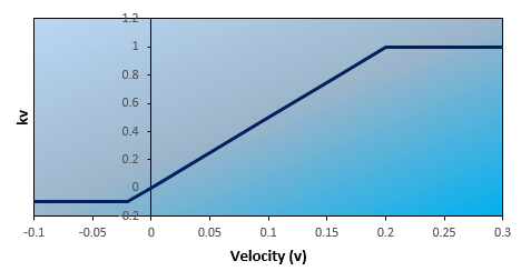

Velocity coefficient kv
The velocity coefficient defines the relationship between headloss and velocity.
For normal and high headloss types, the relationship between kv and v is presented below:
v kv
< -0.02 -0.1
-0.02 to 0.2 -0.1 + (v - (-0.02)) * (1.0 - (-0.1)) / (0.2 - (-0.02))
>0.2 1.0
