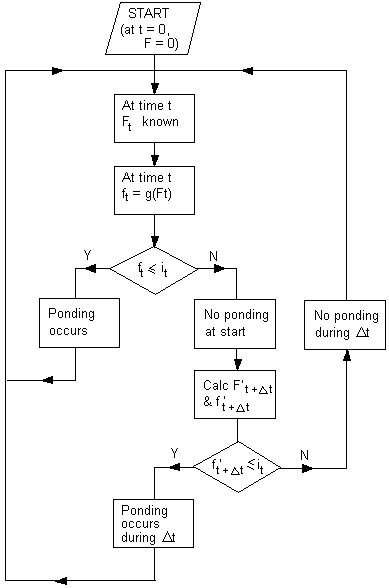

An overview of the calculations is provided in the diagram below. First, the infiltration rate at time t is calculated from Eq. 3. This value is compared with the supply rate of rainfall, i.
General flowchart for infiltration equation ft =(Ft)
If i > f then ponding occurs and the volume of rainfall losses due to infiltration is calculated directly from Eq. 2 over the time interval t.
If f > i then two cases can exist.
If f at the end of the interval t is greater than i, then all the rainfall infiltrates into the soil. If f at the end of interval t is less than i then ponding occurs during the interval t.
Calculating a new infiltration rate f tests the condition' at the end of interval t assuming all the rainfall i infiltrates.
If f' is greater than i then calculate the time to ponding tp.
Following this the rainfall from t to tp is allowed to infiltrate. A new f at time tp is calculated from Eq. 1. Infiltration volume is calculated from Eq. 2 substituting (t-tp) for t.
At the end of these calculations a new storage term is calculated.
