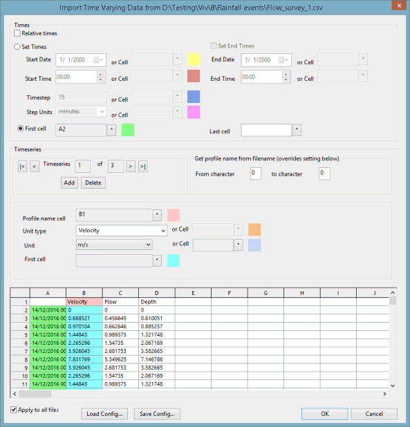

To import flow survey data from a file in general CSV format
- Right click on a Flow Survey (to create a new event) or Flow Survey Event (to append data to an existing event) in the
Explorer Window and select Import
rom generic CSV file from the popup menu. A standard Windows Open Dialog will be displayed.
- Select the files to be imported (multiple files may be selected) and click on Open. The Import Time Varying Data from CSV Dialog will be displayed.
- Set the import parameters on the import dialog. Values can be entered directly or read from the file to be imported. To read a value from the file: click on a cell in the grid at the bottom of the dialog and then on the * button.
Times: Tick the Relative times check box if you want to use relative times, or specify the time range of data to be imported:
- If the file contains a date-time column, use the Start Cell and End Cell fields to enter the cells defining the time range of data to be imported.
- If there is no date and time information, specify start and end times and a timestep interval.
(Specification of an end time is optional; if no end time is specified all data from the first cell to the end of the timeseries will be imported.)
- Get profile name from file (optional). If you want to use the name of the imported file as the event profile ID(s) (link label or node reference), then enter the range of characters in the file name to be used. For example, when importing a file named Monitor1_001, enter a From character of 8 and a To character of 12 to assign a profile name of 1_001, or to use the full file name, specify a From character of 1 and a To character of 12. If you do not want to use the file name as the profile names in the event, then do not specify anything in this pane and use the Profile cell name instead.
Timeseries: set the parameters for each time series in the file:
- For each timeseries (column of data) to be imported a Unit Type and Unit must be defined. The Add and Delete buttons can be used to include and exclude timeseries from import. The underlying data will not be changed.
- To use an entry in the imported CSV file as the profile name in the event, select the cell in the grid at the bottom of the dialog containing the identifier and click on the * button next to the Profile name cell field.
- In the grid at the bottom of the dialog, click on the first cell containing valid data values and then on the * button next to the First cell field to add the current grid cell to the First cell field.
- If you are importing multiple CSV files, then check the Apply to all files box to apply the current settings to all the files being imported. If the option is unchecked, the Import Time Varying Data from CSV dialog will be displayed before the import of each selected file.
- Click OK to complete the import. A profile will be created for each data series imported.
The settings for commonly used file types can be saved. Set up import parameters on the dialog, and then use the Save Config button to save them to a file. The Load Config button can then be used to open an existing configuration.
