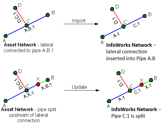

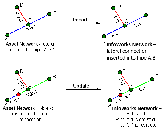

Lateral Creation
Lateral nodes and links created
The pipe to which the lateral is connected (in the asset network) is split in the InfoWorks network creating a new pipe downstream of the lateral.
Lateral Deletion
Lateral nodes and links deleted
Lateral nodes and links deleted in the asset network are deleted from the InfoWorks network. The pipes that were connected to the lateral node are joined and the properties from the pipe upstream of the lateral are used.
Pipe Splitting
Pipe split downstream from a lateral
A new pipe is created downstream from the lateral.
Example
Pipe Splitting
Pipe split upstream from a lateral
A new pipe is created between the inserted node and the lateral. The new pipe and the pipe downstream from the lateral will be updated with the properties of the newly created pipe in the asset network.
Example
