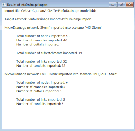

An import report will be displayed with any import errors or warnings. It will also include the full path of the iddx file which was imported together with the full path in the InfoWorks ICM tree of the target network.
Create New Node dialog
For an iddx file with a single InfoDrainage network, all data is imported into the currently selected scenario of the target network in InfoWorks ICM.
For an iddx file with multiple InfoDrainage networks, the data from each InfoDrainage network is imported into a different scenario in the target network. For example, a InfoDrainage network with name "XXXXX" the corresponding scenario in InfoWorks ICM is named "ID_XXXXX". If a scenario does not already exist, a new one will be created.
For each scenario the report provides the total number of imported objects of different types.
Note: Due to the display precision set on the property fields in InfoWorks ICM, some of the displayed values of the imported InfoDrainage attributes will be truncated. However, the attribute value imported to the database from InfoDrainage will not be truncated.
