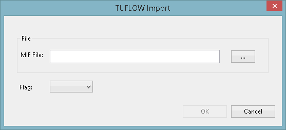

  1. Open the network to be updated.
  2. Select ImportModelfrom TUFLOW network data from the Network menu, and the TUFLOW Import dialog is displayed.
  3. Enter the path to the MIF file to be imported, or click to display a Windows File Open dialog and browse for the file.
  4. If required, choose a flag from the Flag dropdown menu. If information of the selected type is included in the import, then it will be marked with the selected flag.
  5. Click OK.
