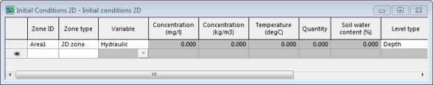

Initial Conditions 2D Grid Window
To open an Initial Conditions 2D Grid Window for editing, either drag the Initial Conditions 2D object from the Explorer window onto the main window background, or right click on the item and choose Open from the popup menu.
| Field | Description |
Zone ID |
Name of 2D Zone or 2D IC Zone |
Zone type |
Select the type of zone that the initial condition is to be applied to from the dropdown: |
| Variable |
Select the type of variable to be set from the dropdown:
| Concentration |
Enabled when Variable is set to a water quality determinant type. Initial concentration of determinant. |
Concentration (Salt) |
Enabled when Variable is set to SALT Initial concentration of salt. |
| Temperature |
Enabled when Variable is set to TW_DIS Initial water temperature. |
| Quantity |
Enabled when Variable is set to PH_DIS or COLDIS Initial pH or coliform value. |
| Horton soil water content |
Enabled when Variable is set to Infiltration Initial soil moisture content for use when using the Horton infiltration model. |
| Green-Ampt soil moisture deficit (%) | Enabled when Variable is set to Infiltration
The initial soil moisture deficit (i.e. the difference between soil porosity and actual moisture content) in the Green-Ampt Model. The percentage entered must be greater than or equal to zero and less than or equal to 100. If no Green-Ampt soil moisture deficit (%) is specified as an initial condition 2D, then the soil moisture deficit is set to zero, and the ground is assumed to be saturated. |
| DefConLoss initial deficit | Enabled when Variable is set to Infiltration
The amount of water required to saturate the soil layer to the maximum storage in the Deficit and Constant Loss infiltration model. |
| CNSWMM antecedent moisture condition | Enabled when:
The initial antecedent moisture condition (AMC) used by the CNSWMM infiltration model. The dropdown contains the following options:
Level type |
Select an option from the dropdown:
Depth |
Enabled when Variable is set to Hydraulic or Bed sediment and Level Type is set to Depth Initial height of water at the centroid of the mesh element relative to ground level when Variable is set to Hydraulic. Initial thickness of sediment layer at the centroid of the mesh element relative to ground level when Variable is set to Bed sediment. |
Elevation |
Enabled when Variable is set to Hydraulic or Bed sediment and Level Type is set to Elevation Initial height of water (above datum) at the centroid of the mesh element when Variable is set to Hydraulic. Initial height of bottom level of sediment layer (above datum) at the centroid of the mesh element when Variable is set to Bed sediment. |
Speed |
Enabled when Variable is set to Hydraulic Initial velocity of water in mesh element. |
Direction |
Enabled when Variable is set to Hydraulic Initial direction of flow in mesh element. Angle in radians from due East. |
| Layer |
Enabled when Variable is set to Bed sediment Layer to which the initial conditions are to be applied:
| Layer composition type |
Enabled when Variable is set to Bed sediment The method by which composition of layer is to be entered for each sediment fraction:
| Layer concentration sf1 |
Enabled when Variable is set to Bed sediment Percentage of initial mass of sediment fraction 1 if Layer composition type is set to Mass concentration. Percentage of initial volumetric concentration of sediment fraction 1 if Layer composition type is set to Volume concentration. |
| Layer concentration sf2 |
Enabled when Variable is set to Bed sediment Percentage of initial mass of sediment fraction 2 if Layer composition type is set to Mass concentration. Percentage of initial volumetric concentration of sediment fraction 2 if Layer composition type is set to Volume concentration. |
