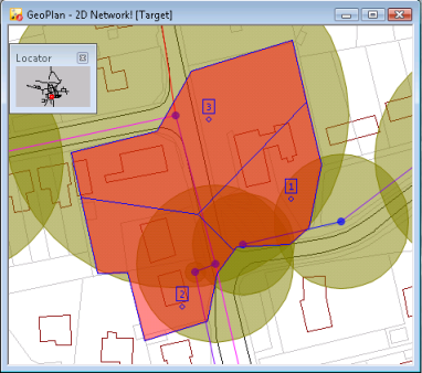

InfoWorks ICM supports spatially varying rainfall by the use of rain gauge boundaries which define which region is covered by a particular rain gauge. Boundaries are imported or digitised onto the GeoPlan view and then associated with a Rainfall event. InfoWorks ICM can then apply the correct rain gauge to subcatchments, buildings and 2D mesh elements falling within the rain gauge boundaries.
Creating rain gauge boundaries using Thiessen Polygons
Rain gauge boundaries can be created automatically in InfoWorks ICM using the Thiessen Polygon method.

Generate boundaries from the GeoPlan menu. Rain gauge boundaries will be generated using the Thiessen Polygon method.
- Save the rain gauge boundaries by associating the boundaries with a Rainfall Event.

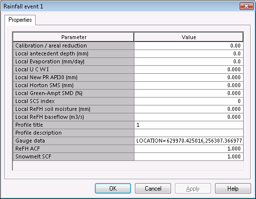

InfoWorks ICM uses the rain gauge profile number to apply the boundary data to the rainfall event. If there is a profile in the rainfall event with a profile number that matches a rainfall boundary, the boundary information is added to the Gauge data field for the profile.
All profiles in the event must have boundary information before spatial rainfall can be used in simulations. Simulations will fail if there are profiles without boundary information.
Simulations will fail if subcatchment or building centroids fall outside of the defined rain gauge boundaries.
