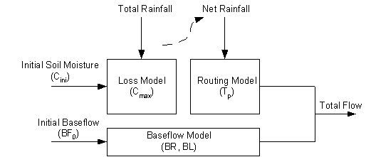

The ReFH model consists of the same three main components as the original FSR/FEH model: a loss model, a routing model and a baseflow model:

Loss Model Component
The loss model is based on the Probability Distributed Model (PDM). Effective rainfall is evaluated sequentially during a storm and if soil storage is filled, runoff will equal 100%.
The required input parameters are:
- Cini - initial soil moisture content specified in the Rainfall Event initial conditions
- Cmax - maximum soil moisture capacity specified in the Subcatchment Data Fields
Cini and Cmax can be either user defined or estimated from catchment descriptors.

Baseflow Model Component
The baseflow model is based on the linear reservoir concept with a characteristic recession defined as an exponential decay.
- BF0 - initial baseflow specified in the Rainfall Event initial conditions
- BL - baseflow lag specified for the Subcatchment Data Fields
- BR - baseflow recharge specified for the Subcatchment Data Fields
All three baseflow parameters can be user defined or estimated from catchment descriptors.
