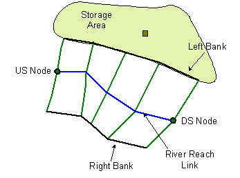

Building reach bank connections
Each river bank may be connected to a single object of type River Reach, Storage Area or 2D Zone into which flow from the river reach can spill. (See the River Reach - Bank Flows topic for information on the calculation of bank flows).
The ID of the bank connection object can be manually entered into the property sheet of the River Reach.
Alternatively, bank connections can be built automatically by selecting River reachBuild bank connections from the Model menu.
When building reach bank connections automatically, each bank of the river is analysed for any overlapping or touching objects. If there is more than one overlapping object per bank, the order of preference is as follows:
  • River Reach
  • Storage Area (must have an associated Storage Node in order to be considered as a bank connection object)
  • 2D Zone
If there is more than one object of the same type overlapping a bank, the object containing or touching the most bank vertices with its polygon boundary will be used as the bank connection object.
Note: Overlapping objects that do not contain any bank vertices will be ignored by the automatic build process.
The Left/Right reach node ID, Left/Right reach link suffix, Left/Right storage node ID and Left/Right 2D zone ID fields of the River Reach object will be populated according to the rules described above.
Storage Area with associated Node overlapping left bank of river reach. Building reach bank connections will populate the Left storage node ID field of the River Reach with the ID of the Storage Node.
Note: Using the automatic Build bank connections option will clear all previously assigned bank connections.

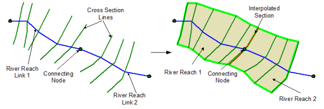

Interpolating river sections
It is possible to create new River Reach cross sections by interpolation by clicking on a River Reach link between two existing river sections.
To interpolate new cross sections
  1. Click on the New Interpolated Section button on the More GeoPlan Tools Toolbar.
  2. Click on a River Reach link between two existing river reach sections
The Interpolation Viewer is displayed. When the viewer is first displayed, the data displayed will allow a single interpolated section to be inserted at the location clicked on. Click the Build button to create the section.
To adjust the number of sections created and to add chords to map specific points from upstream section to downstream section in order to improve the accuracy of the sections interpolated, edit the settings on the Interpolation Viewer.
Interpolated sections are inserted between the two existing sections, and corresponding Cross Section Line objects are created.
  • New sections are named using the convention <upstream section id>-x-<downstream section id>, where x is an integer used to make multiple inserted section IDs unique e.g. 'section1-3-section2'.
  • Bed level and XY coordinates of vertices of the new section are determined by calculating a weighted average of the upstream and downstream sections based on how far along the reach link between the two sections the interpolated section is located.
  • Roughness values of the new section are copied from the upstream existing section.
  • Panel markers are not set.
If the river reach has a bank, a new bank point will be inserted for the new section. However, any existing boundary will remain unchanged.
When inserting an interpolated section, a corresponding Cross Section Line object is created automatically. This allows the reach geometry to be rebuilt from line data if required and keeps the line data as consistent with the river object as possible.
Conveyance data for the new sections is also generated when the two existing river reach cross sections are interpolated:
  • if both of the existing sections contain user-defined conveyance data, a curve is generated by interpolating the two user-defined curves
  • if only one of the existing sections contains user-defined conveyance data, a curve is generated by interpolating the user-defined conveyance curve with the other section’s calculated curve
  • if neither section contains user-defined conveyance data, a curve is generated by interpolating the calculated curves of both the existing sections

Multiple Reach Building
If multiple River Reaches are selected, the chosen build operation will be carried out on all selected River Reaches.
If the reaches are connected, an interpolated section will be inserted at the connecting node point to join the connecting reaches before the other build operations are attempted.
Exceptions to the joining of connected multiple reaches are as follows:
  • If more than two reaches meet at a node the reaches will be built separately (no section interpolation or joining of boundaries and banks), even if only two reaches have been selected for carrying out building operations.
  • If two reaches are joined by a node at the upstream end of both reaches, or the downstream end of both reaches, the reaches will be built separately.
When building banks for multiple River Reaches, only two bank lines (assumed to be left and right bank) may be selected at a time. However, each bank object may extend over multiple reaches.
