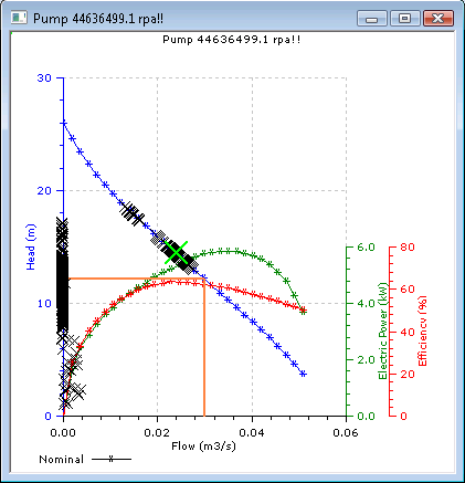

The operation of a rotodynamic pump can be analysed by graphing the curve for the pump including display of all the operating points for the pump during the simulation.
To display a graph of pump operation
  • Open simulation results in a GeoPlan Window
  • Click on the pump to be analysed using the Pick Graph tool. The Pump Graph Dialog will be displayed.
  • Select the Pump operation option from the Pump Graph Dialog. A graph of pump operation will be displayed.
Pump Operation Graph

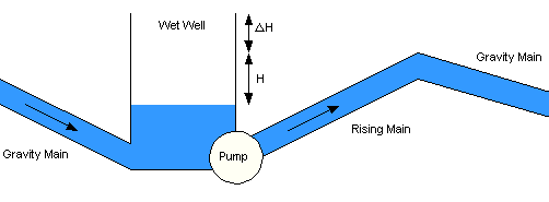

The head across the pump includes the difference between the wet level in the wet well and the water level at the top of the rising main (H). It also includes any friction losses in the rising main itself (ΔH). This is demonstrated in the diagram below.
Pump Head
H is the head difference between water levels
ΔH is the friction loss in the rising main itself

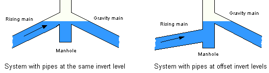

Another reason the pressurised pipe model may not be implemented is if the top of the rising main is not completely full, as shown in the diagram below left.
This is solved by ensuring that the invert level of the downstream gravity pipe is above the soffit level of the rising main. See the diagram below right.
