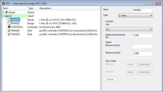

RANGE 1
Range type: Q - flowLocation link: H.1Minimum: Maximum: 0.580 m3/s
TRUE if flow in conduit H.1 is less than 0.580 m3/s
RANGE 2
Range type: Q - flowLocation link: H.1Minimum: 0.580 m3/sMaximum:
TRUE if flow in conduit H.1 is more than or equal to 0.580 m3/s

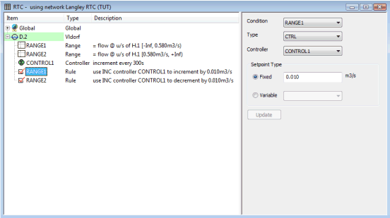

RULE 1
Condition: RANGE 1Rule type: CTRL
Controller: CONTROLLER 1
Setpoint: FIXED 0.010 m3/s
Increment REGULATOR by 0.01 m3/s if RANGE 1 is TRUE

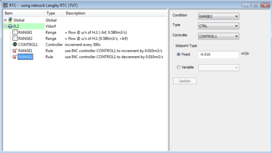

RULE 2
Condition: RANGE 2Rule type: CTRL
Setpoint: FIXED -0.010 m3/s
Decrement REGULATOR by 0.01 m3/s if RANGE 2 is TRUE
  1. Range 1: Defines Link H.1 as a control conduit with a maximum value of 0.580 m3/s
  2. Range 2: Defines Link H.1 as a control conduit with a minimum value of 0.580 m3/s

  4. Rule 1: If the flow in Link H.1 is less than 0.580 m3/s, increments orifice setting by 0.01 m3/s
  5. Rule 2: If the flow in Link H.1 is more than or equal to 0.580 m3/s. decrements orifice setting by 0.01 m3/s
