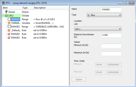

RANGE 1
Range type: Q - flow
Location link: 120.1
Distance Downstream: 0m
Minimum:
Maximum:
TRUE if flow in conduit 120.1 is between +/- infinity

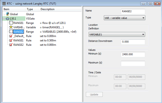

RANGE 2
Range type: Variable
Location definition: VARIABLE 1
Minimum: 2400 s
Maximum:
TRUE if VARIABLE 1 is greater than 2400s

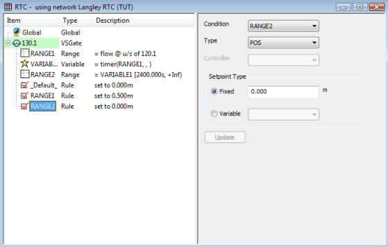

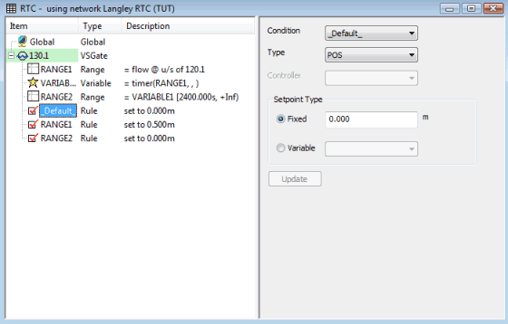

RULE 1
Condition: _default_
Rule type: POS
Setpoint Type: FIXED 0.000 m
DEFAULT status of gate is Closed

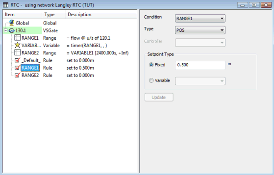

RULE 2
Condition: RANGE 1
Rule type: POS
Setpoint Type: FIXED 0.500 m
Set sluice gate to 0.5 m if RANGE 1 is TRUE
RULE 3
Condition: RANGE 2Rule type: POS
Setpoint type: FIXED 0.000 m
Set sluice gate to 0.0 m if RANGE 2 is TRUE
  1. Range 1: Defines Link 120.1 as a control link

  3. Range 2: Defines the calculated time in Variable 1 as a control with a minimum value of 2400s (40 mins)
  4. Rule 1: Unless subsequent rules are TRUE, sluice gate is closed
  5. Rule 2: Unless subsequent rules are TRUE, sets sluice gate opening to 0.5 m
  6. Rule 3: When the Timer defined in Variable 1 reaches 2400s (40 mins), sluice gate is Closed

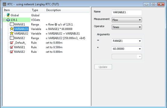

Variable Example 2
The following example models controlling the operation of a sluice gate, by measurement of the total flow through a conduit. When the total flow in the conduit reaches a given volume, the sluice gate will be closed.
In this example, a variable is used to convert the flow measured in the control conduit to a cumulative flow over a timestep. A second variable is used to keep a total of the cumulative flow.

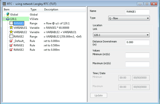

RANGE 1
Minimum:
Maximum:
TRUE if flow is between - / + infinity

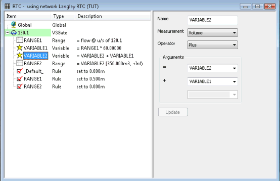

VARIABLE 1
Measurement: Flow
Operator: Times
Argument 1: RANGE 1
Argument 2: Constant = 60
Equals RANGE 1 flow multiplied by 60
VARIABLE 2
Measurement: Volume
Operator: Plus
Argument 1: VARIABLE 2
Argument 2: VARIABLE 1
Equals VARIABLE 1 + VARIABLE 2

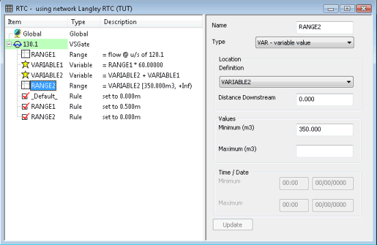

RANGE 2
Location definition: VARIABLE 2
Minimum: 350 m3
Maximum:
TRUE if VARIABLE 2 is greater than or equal to 350 m3

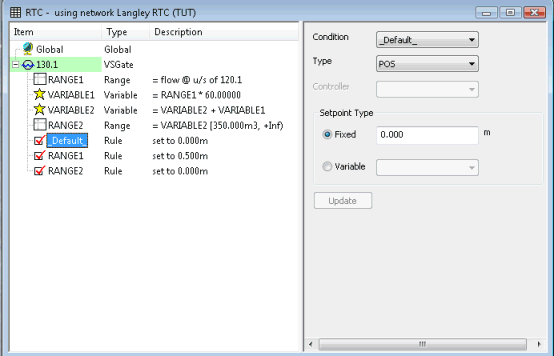

RULE 1
Rule type: POS
DEFAULT status of sluice gate is 0.0 m

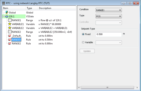

RULE 2
Condition: RANGE 1
Rule type: POS

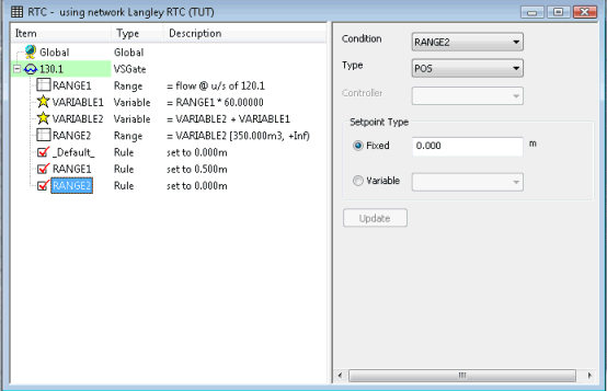

RULE 3
  1. Range 1: Defines Link 120.1 as a control link in which flow is measured
  2. Variable 1: Calculates total flow over timestep
  3. Variable 2: Calculates cumulative flow through Link 120.1
  4. Range 2: Defines Variable 2 as a control with a minimum value of 350 m3
  5. Rule 1: Unless subsequent rules are TRUE, sets sluice gate to 0.0 m
  6. Rule 2: Unless subsequent rules are TRUE, sets sluice gate to 0.5 m
  7. Rule 3: When cumulative flow through Link 120.1 reaches 350 m3, sets sluice gate to 0.0 m
