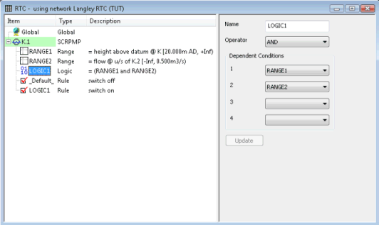

RTC Window Editor - Logic Pane
The output from up to four Ranges or Logic operators can be combined to give a TRUE or FALSE result. This result can be used as the input to either another logic operator or a rule.
If logic operators are defined under the Global object any regulator definition can access them. Logic operators that are part of a regulator definition are local to that regulator definition. A local definition is used in preference to a global definition with the same label.
The Logic pane contains the following fields:
Name
The label that identifies the result of this logic definition
Operator
A logical operator (see below)
Dependent Conditions (1 to 4)
Input conditions. Each of the conditions is either the label of a previously-defined Range or Logic definition, or it is left blank.
At least one input condition must be given for the NOT operator and at least two for all other operators
