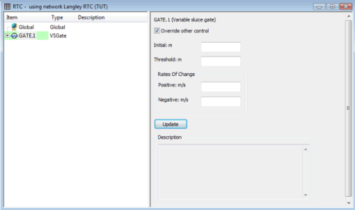

A regulator marks the start of a block of records defining the operation of one regulator structure in the system. The block can contain rules and indirect controllers and can also contain local definitions of measurement ranges and logic rules.
The Regulator pane contains the following fields:

Override Other Control checkbox
The status of the Override Other Control option affects whether the switch on levels in the network pump data are used in a simulation or not.
The option is only relevant for pumps; the setting is ignored for other regulator types.
  • Checked -the simulation engine uses the rules in the RTC Scenario only to switch a pump on. Switch on levels in the pump network data are ignored.
  • Un-checked - the switch on level information in the pump network data is used in addition to the rules defined in the RTC Scenario.
The regulator text (displayed in the left hand pane of the RTC Window) is highlighted red if the Override Other Control checkbox is unchecked, and green if it is checked.
Note: The switch off level, specified as part of a pump's properties, will always be used during a simulation.
